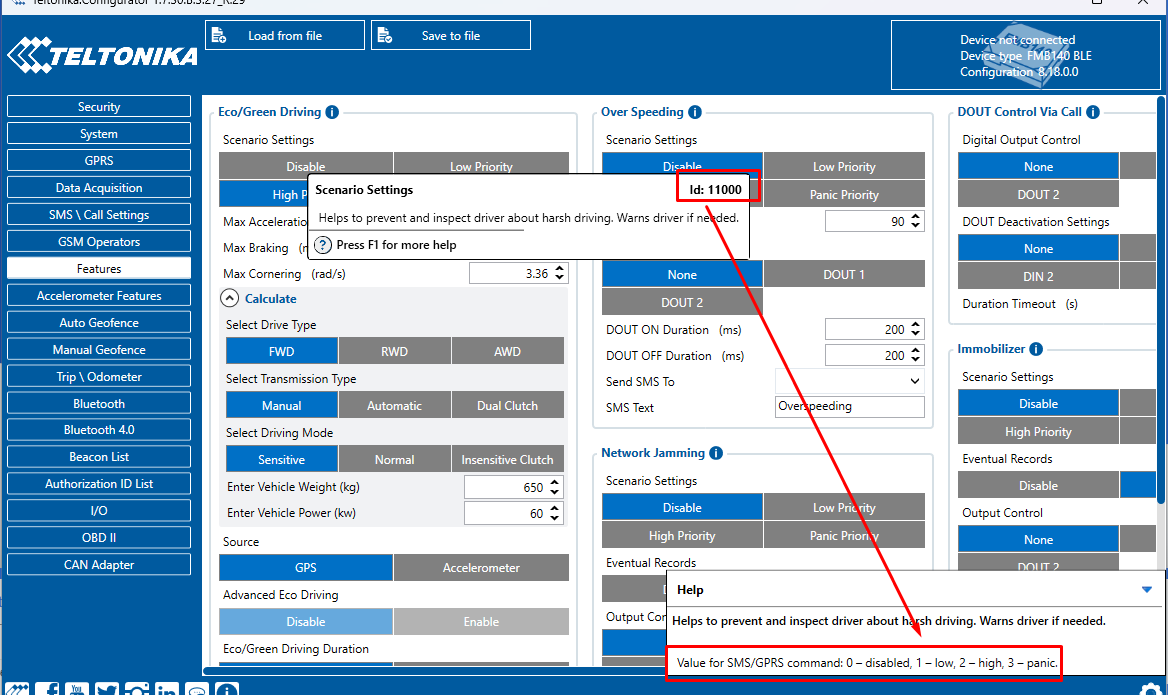

So your question is to configure the device via SMS to do this you can send setparam command
for example, if you want to set the priority for the eco-driving you need to send
from the photo above you can see the parameter ID and the parameter value to view this mouse over the mouse to the parameter and the parameter ID will show.
To send set param command please follow this link: FMB setparam - Wiki Knowledge Base | Teltonika GPS (teltonika-gps.com)
SMS command example below to change the priority of Eco/Green Driving
setparam 11000:2
