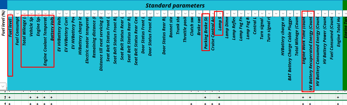

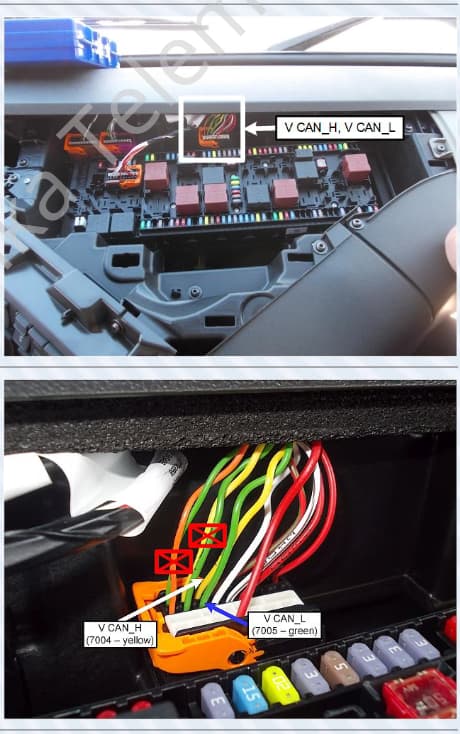

We have installed the FMC150 on a Volvo FM Mk3 for our client, who operates an entire fleet of Volvo trucks. We are able to retrieve all CAN data except for “Total Fuel Consumed,” which is crucial for our client.
Could you please advise on a solution to obtain the fuel consumption value from the CAN data using the FMC150 or another Teltonika device?
Thank you in advance for your support.
  • FMC 150 firmware : 03.29.00.Rev.157
  • Volvo FM mk3 ( year 2016 & 2014 )
  • Connection used from the file : Volvo_FM_mk3_2013-2020_V8.0.pdf

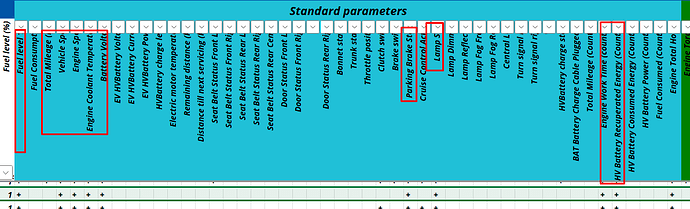

Good day, based on the supported parameter of that vehicle it does not include the Total Fuel consumed.
reference; FMX150_Supported_Vehicles_03_06_2025.xlsx
Another option is to do the calculation from your server using the Fuel level parameter.

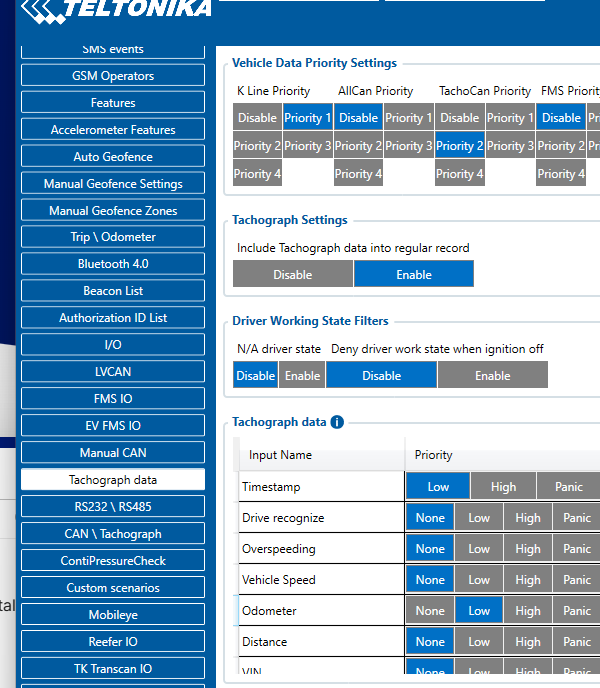

Hello Maynard,
we tested FMB640, from FMS data we cannot see the Total Odometer from FMS interface.. also after checking FMX6XX Sending Data on Wiki Documentation no Total Odometer Parameter from FMS data is available .. is that right ? how we can retreive the total odometer from CAN with FMS data from FMX6XX ?
Greetings
Sometimes the Total odometer will appear on the Tachograph IO
