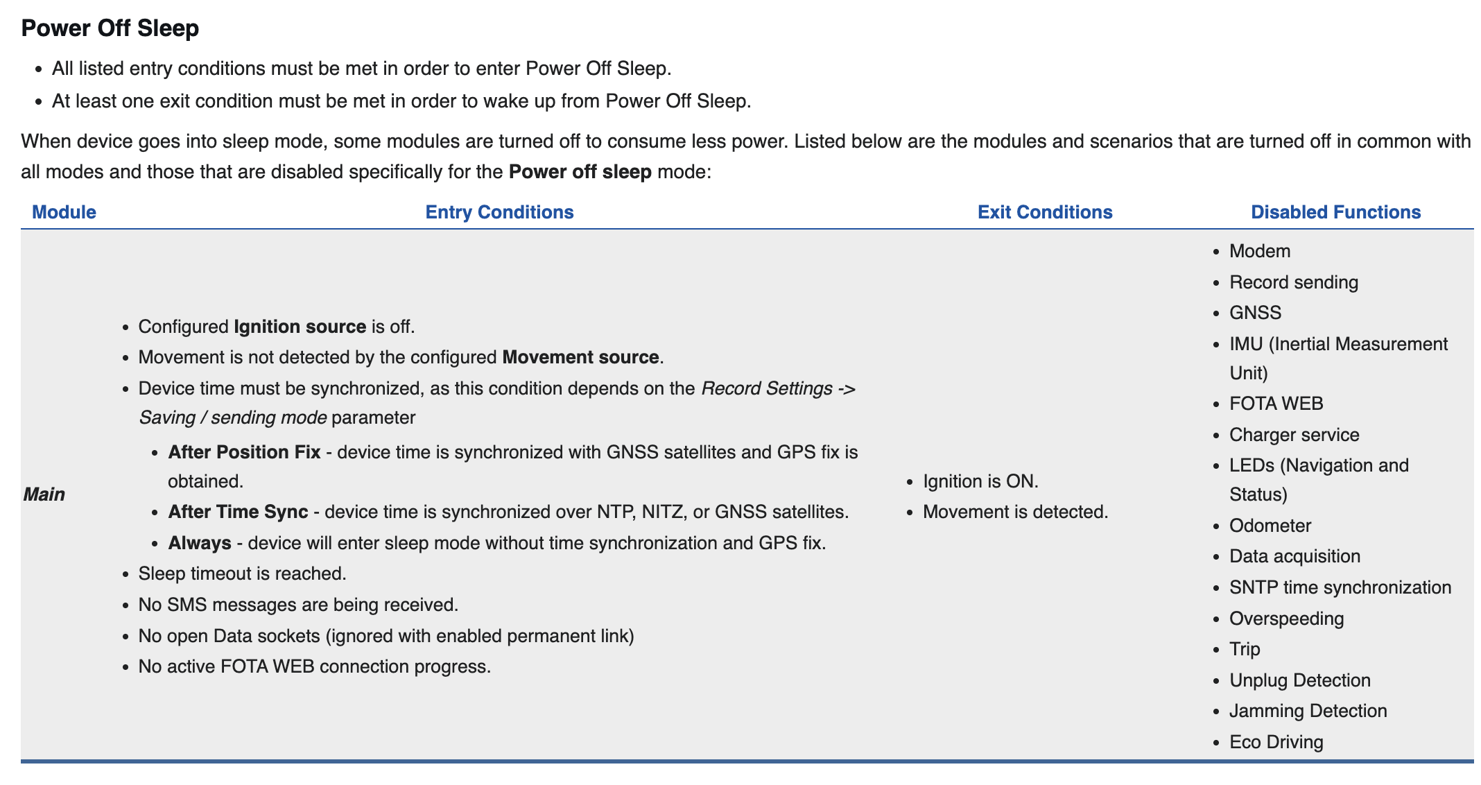

Hello @JamesS
Yeah, ignition statues, movement, or on-going task can prevent the device entering sleep mode,
Kindly check this link FTC880 System - Teltonika Telematics Wiki

Hi Laith,
Thanks, I read through the wiki prior. As I mentioned above, I believe all the sleep conditions have been met:
I have a GPS fix, movement source is set to ignition, ignition source is set to voltage and is off. No open sockets, FOTAweb connections or SMS being processed, sleep timeout is reached.
I’m going to have to start looking at logs….
