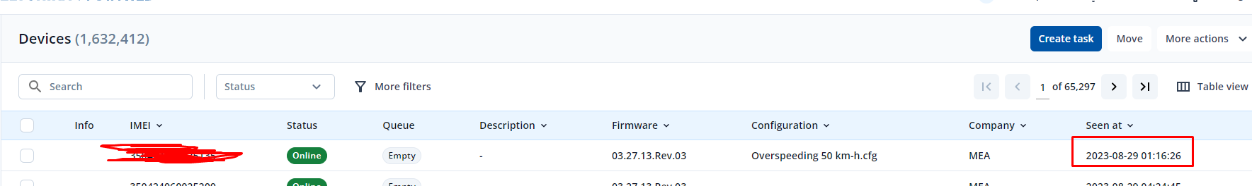

Is the device able to communicate in FOTAWEB? like the example below

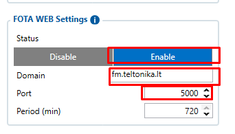

If the device is not able to communicate in FOTAWEB kindly check your device configuration
Make sure that the FOTAWEB Status is enabled, and Domain and Port are properly set.

Yes the Device is able to communicate at FOTA web. i got the “Recieve internal Log” from one of my Tracker. Sure i am also checking the FOTA web Settings for the Other Tacker also
