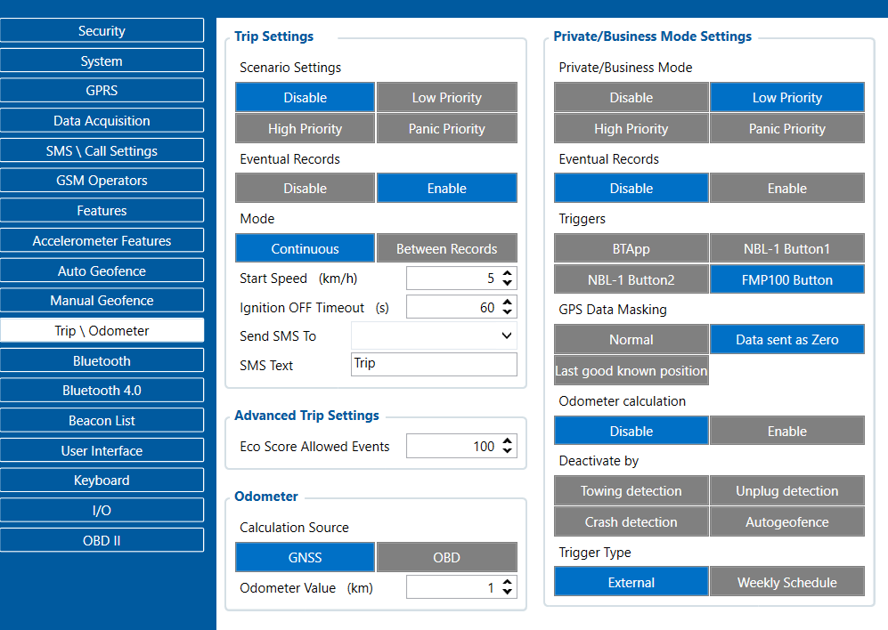

I’m using a FMP100 tracker and I’m trying to use the “Private/Business Mode” to mask GPS data when driving during my private time so it’s not sent to the server. I tried enabling it on Low Priority mode. The disable “Odometer calculation” function does work. But when I try to set the “GPS Data Masking” to “Data sent as Zero”, it just keeps on sending lat & long values.
What am I doing wrong?

I’m using the external trigger (button on top of the FMP100). I’m sure its switching to private because the LED colors change (and I can see io391 changing in the server logs which means Private Mode).
