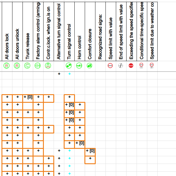

Base on the Photo the orange box means if you use contactless reader then the CAN parameter will not be available you should connect it directly to the CAN lines.
