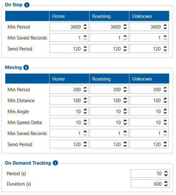

This situation seems to be related to Data Acquisition setting. Have you check the data acquisition setting and is it the updated data to server following the send period setting for Roaming and Unknown? This might be the issue where it is updating once then drop as it have send period time setting. Further detail configuration manual available in our wiki for your reference : FMM003 Data acquisition settings - Teltonika Telematics Wiki
You may also have a look into Records Settings under GPRS tab. This is to control the open link timeout between device and server. You may increase the timeout setting to prevent the link being close prematurely. Further detail information about this configuration available in out wiki page for your reference : FMM003 GPRS settings - Teltonika Telematics Wiki
