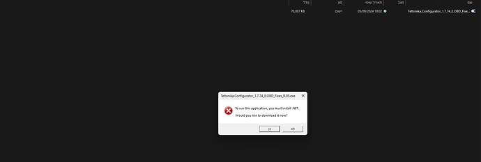

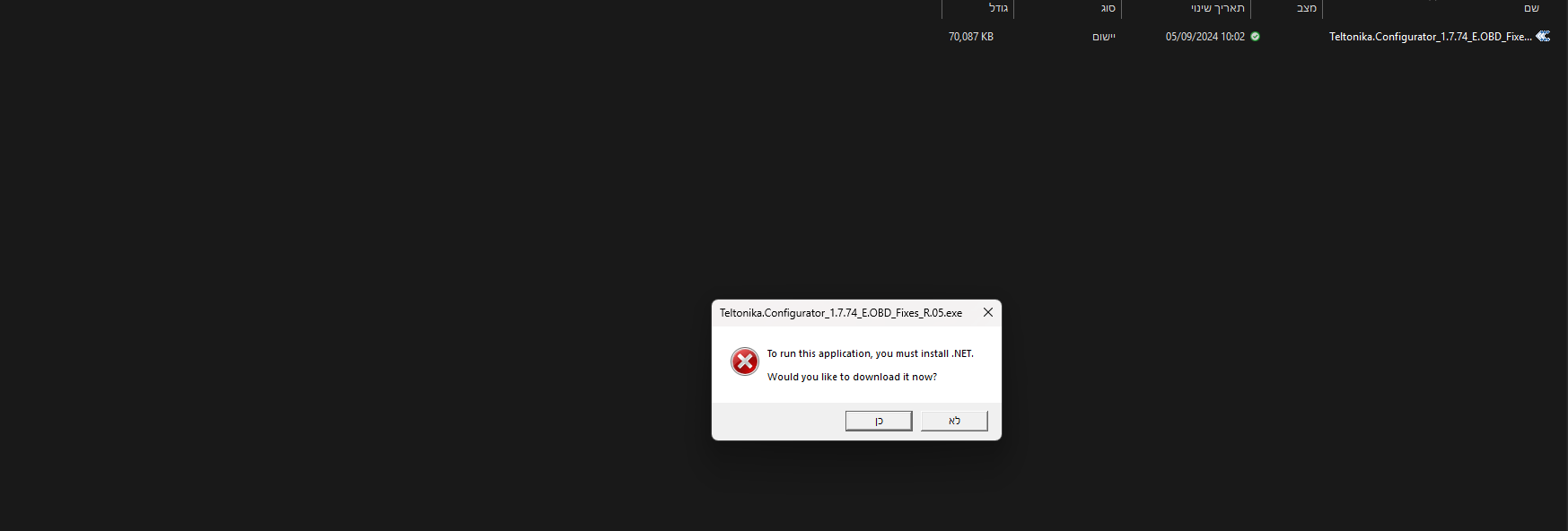

Hi, I just bought a car and found an FMM003 device left by the previous owner. I tried to configure it, but I can’t install the firmware using my laptop (Windows 11 Pro). I keep getting a message saying I need to install .NET, even though I’ve already installed several versions of .NET. The message keeps appearing. Please help!
Hi, I am in the same situation. Found a FMM003 in my new car.
The .NET that you need is Windows Desktop Runtime .NET 5: Download .NET 5.0 (Linux, macOS, and Windows) | .NET
