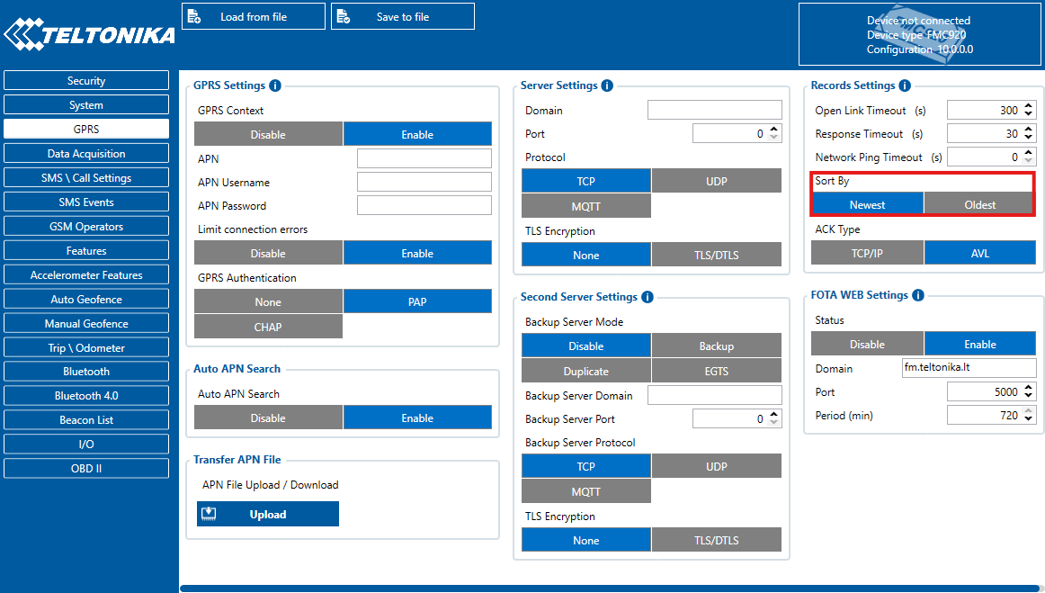

Hello @SasoLicer,
I hope you are doing well. Suggesting you check the Data Acquisition settings of FMC920 then compare them with the FMB920. Also, kindly set the Movement Source for the FMC920 device as Accelerometer.
On the other hand, it is possible that there could be internal data stored on the device’s memory. You may prioritize the new data created by the device by setting the Sort By parameter to Newest.
I hope this helps.
Patrick S.
Thank you now works
