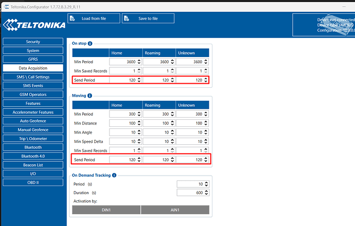

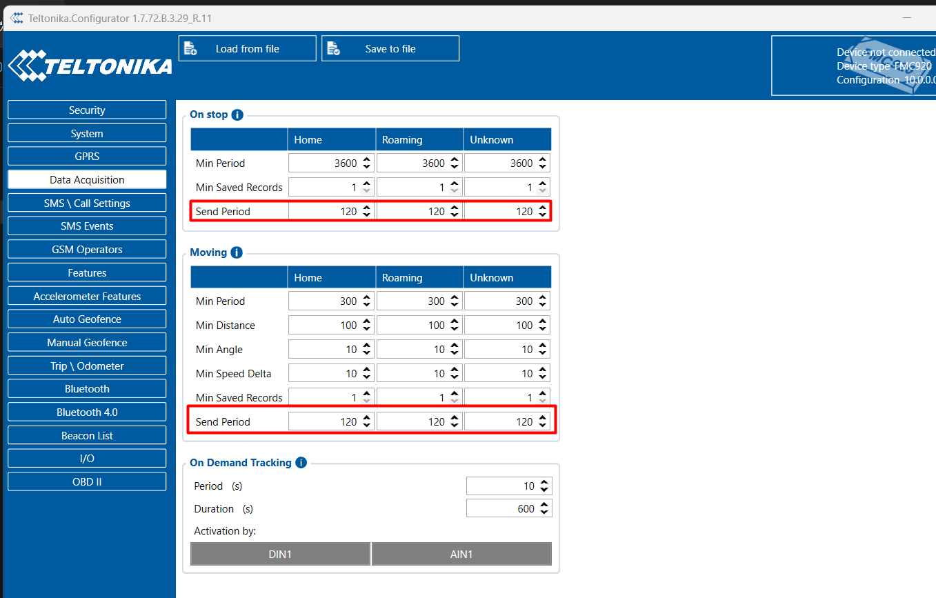

hello
try to check the APN name of the SIM card, with attention to lower/upper case structure, also, check the send period parameter.
Referance; FMC920 Data acquisition settings - Teltonika Telematics Wiki
BR
laith
