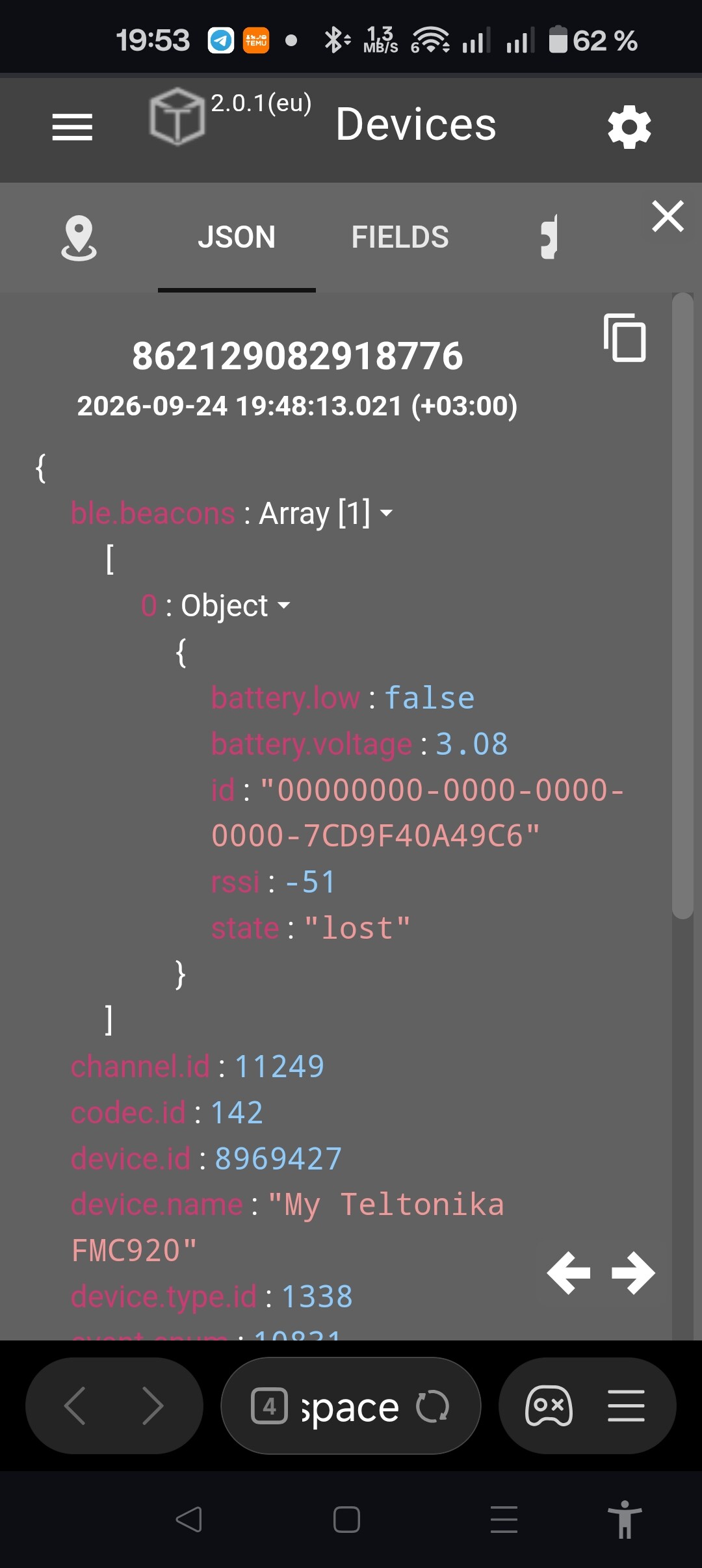

The FMC920 generates AVL event 10831 (Lost EYE Beacon) even when the EYE Beacon is physically next to the FMC920.
The problem is especially reproducible when the FMC920 wakes up or detects movement. The beacon remains next to the tracker and is not moved away.
I confirmed in the raw AVL data that the FMC920 itself generates these events, so they are not generated by the monitoring platform.
Examples:
- Found: AVL 10829
- Lost: AVL 10831
- False Lost events have occurred with very strong RSSI, including approximately -28 to -31 dBm.
I have also observed alternating events such as:
10829 Found → 10831 Lost → 10829 Found → 10831 Lost
while the beacon remains next to the FMC920.

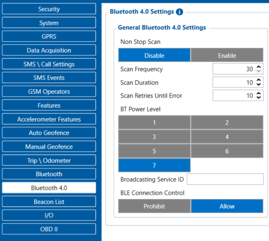

Tests already performed:
- Non Stop Scan enabled/disabled
- BLE Scan Duration changed
- Scan retries tested with different values
- EYE Beacon Clear Timeout tested with 5, 15 and 30 seconds
- EYE List Search RSSI threshold changed from -60 to -90 dBm
- Data Clear Period changed from 10 to 60 seconds
- Tested with external power and FMC920 internal battery
- Standard Beacon Detection disabled while EYE Lost & Found remained enabled
None of these tests eliminated the false Lost events.
