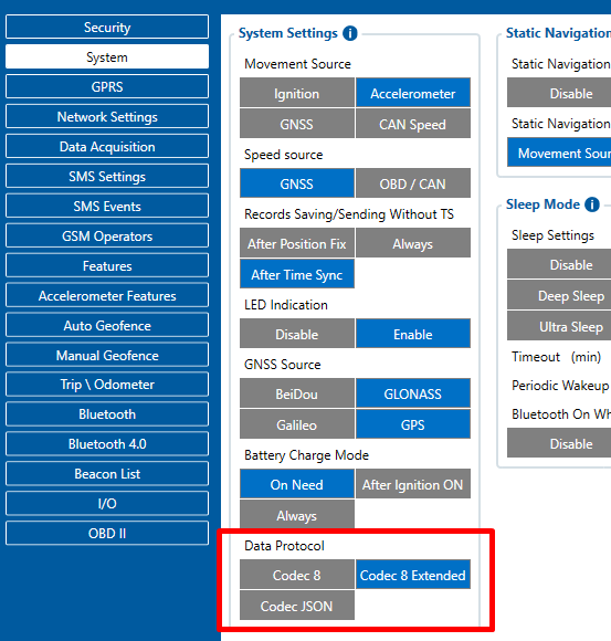

I just want to receive the data from device and show it to my device management platform. Does it always come in codec 8 format to the server or is it configurable.
Anand
Yes it is configurable you can use codec 8, codec 8 extended for your data protocol.
Reference: FMM003 System settings - Teltonika Telematics Wiki
