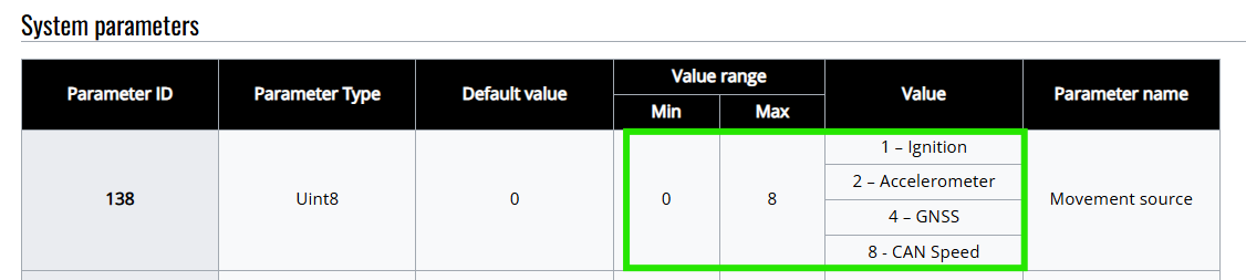

In response to your question, yes, it is possible to configure the movement source via SMS for your FMC920. The “Parameter ID” that refers to the movement source is 138, and depending on your needs, you can configure it as follows:
  • setparam 138:1 - Selects ignition as the movement source.
  • setparam 138:2 - Selects the accelerometer as the movement source.
  • setparam 138:4 - Selects GNSS as the movement source.
  • setparam 138:8 - Selects CAN speed as the movement source.
To correct your comment, the range of possible values is from 0 to 8, but the values it can take are only the ones mentioned above (1, 2, 4, and 8).

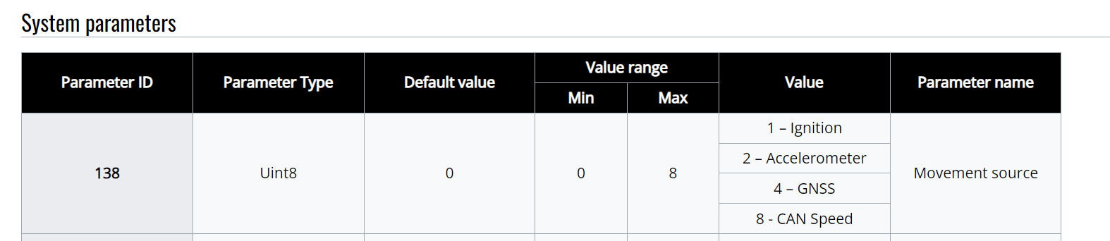

In the following link, you will find the complete list of system parameters supported by your FMC920 device.
FMC920 Parameter list - Wiki Knowledge Base | Teltonika GPS (teltonika-gps.com)

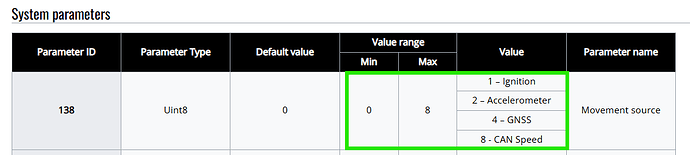

That’s what I needed; thank you.
BTW, I had only tried ‘1’ and ‘2’ for settings, and (incorrectly) concluded that the range was 1-4 (rather than 1,2,4,8).
hello
you can reference to this table
