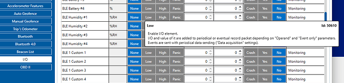

I can’t find the FMC920 BLE 1,2,3,4 HUMIDITY PRIORITY AND SETTINGS ON DOCUMENTATION . Please help
Hi @ramsunrisers

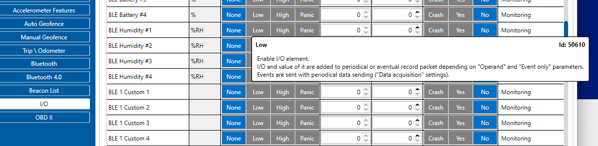

Good day, you can use the configurator to determine the parameter ID, moveover to the parameter that you need and the ID and the description will automatically show.
Note that:
0 - None
1 - Low
2 - High
4 - Panic
