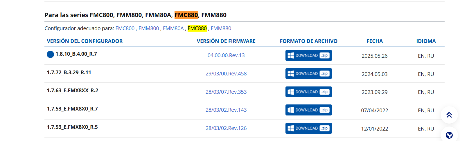

I found these versions, try some
Regards
Thanks, but these are configurator versions. I need the firmware update tool that @Patrick_Sangalang mentioned.
