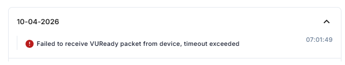

I’m having issues doing a download on TachoSync with an FMC650 device. I can see that the device is able to connect to TachoSync, but it’s not able to authenticate during the download process of a vehicle file.
We already tried to update the firmware to the latest version available (03.01.01.Rev.15) but the error is still the same: Failed to receive VUReady packet from device, timeout exceeded.
We also made sure that the company card was not expired and is connected.
We’ve never been able to do a successful download, which worries me a bit.
At this point we need some technical support to figure out what the cause of the issue is so we can move on.
Could you provide some help please?
Fixed. The problem was caused by bad configuration. We were trying to read can1 when the tacho data was avaiavble on can2
