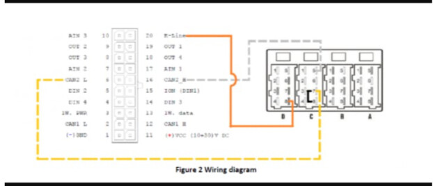

I had connect the Tachograph with FMC650 using the attached wiring diagram.

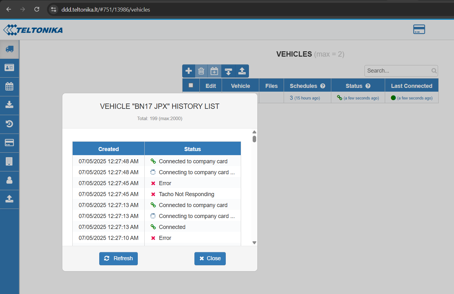

After wait a long time i am not able to download the tacho files at Web Tacho . At web Tacho i am getting this. snip attached

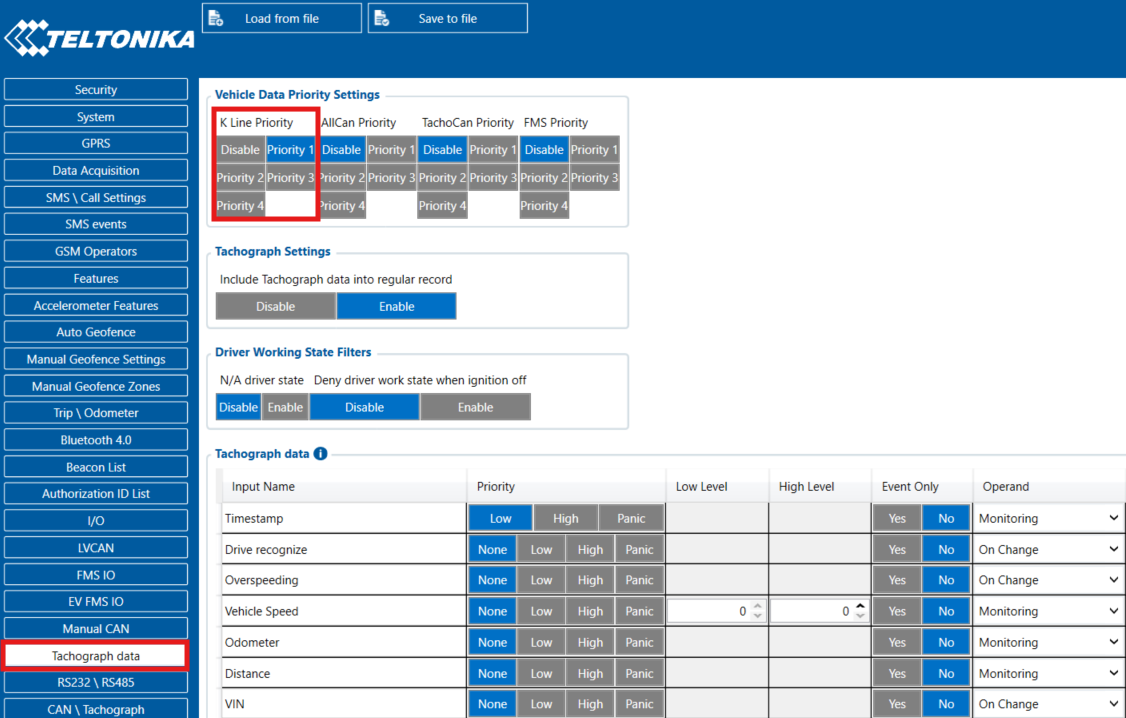

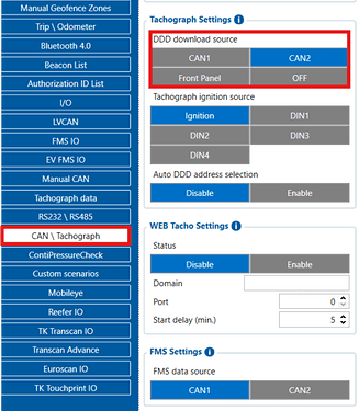

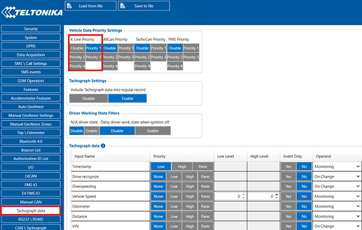

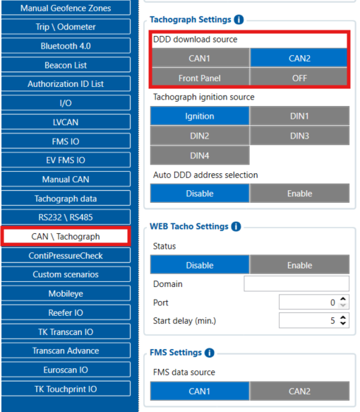

Is this the configuration Issue ? does i need to change anything in Configuration or it is wiring (Connection ) issue ?
Although i am getting K-Line:1 , so is there any possibility that i get tacho files from K-LIne ? how ?
