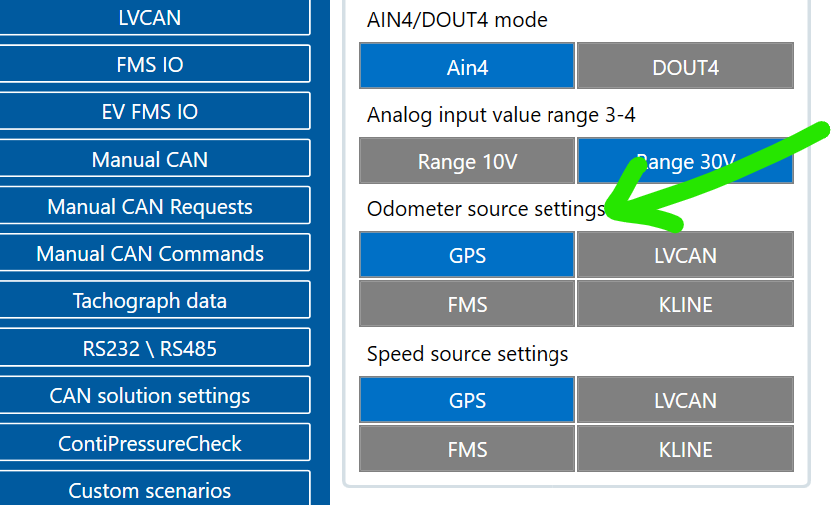

Please explain what the “ODOMETER SOURCE SETTING” means in the device configuration. Will the device send odometer reading data based on GPS, FMS, LVCAN, or KLINE? If GPS is selected, what value is transmitted by the device?
Hello @michaly
This parameter will define from where the device will receive the ODOO meter value (mileage) “AVL ID 16”
If GPS is selected, then the device will calculate the ODOmeter internally based on the GPS signals and send the counter value in ID 16 to the server with the record
