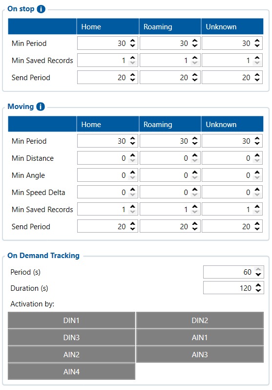

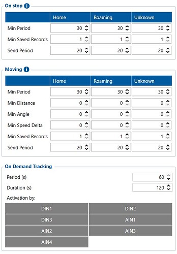

The device is configured for both Moving and On-Stop profiles with the following settings:
  • Min Period: 30 seconds
  • Min Saved Records: 1
  • Send Period: 20 seconds

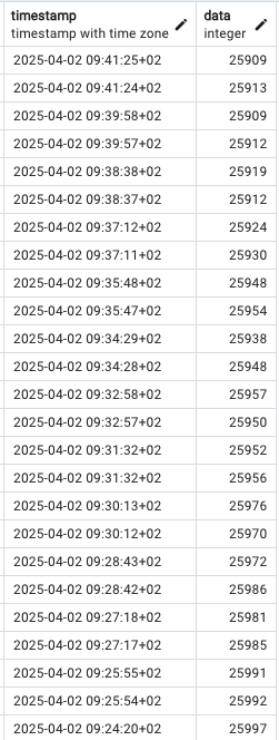

Despite these settings, the device does not send data at the expected 20‑second intervals. Instead, records are transmitted in bursts. For example, our server logs show that a batch of data was processed with a timestamp of 04:27:53 and then the next batch was processed at 04:29:49—an interval of nearly 2 minutes. Our database items for timestamps (see attached screenshot) confirm that the records are stored with these delayed timestamps rather than the configured 20‑second period(we are getting time stamp information from the message data).
This indicates that the device is aggregating multiple records and releasing them in delayed bursts instead of adhering to the defined transmission schedule.

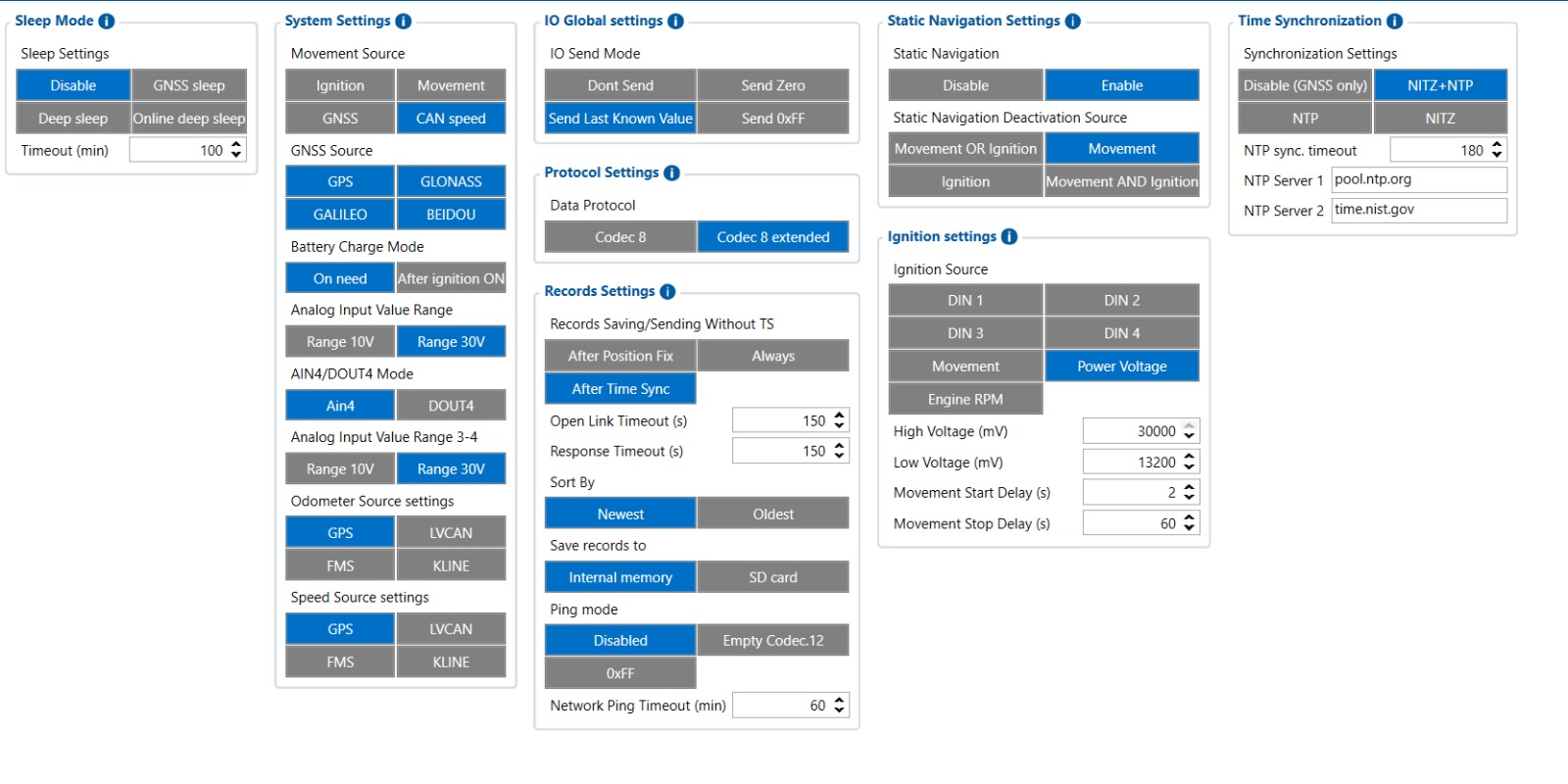

Here are the current settings:
Doruk
