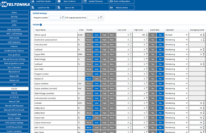

Hello, how to configure PROGRAM NUMBER and CAN with FMC650 in DAF XF106 2016? FMC650 hasn’t sent any CAN readings.
Hello @michaly,
I hope you are doing well. Were you able to connect an external LVCAN200 CAN adapter to the FMC650 device? It is mandatory to have an external adapter if you wish to configure the LVCAN200 Settings.
For more information you may refer to this link: FMC650 LVCAN I/O,FMS IO and Tachograph data elements - Teltonika Telematics Wiki
