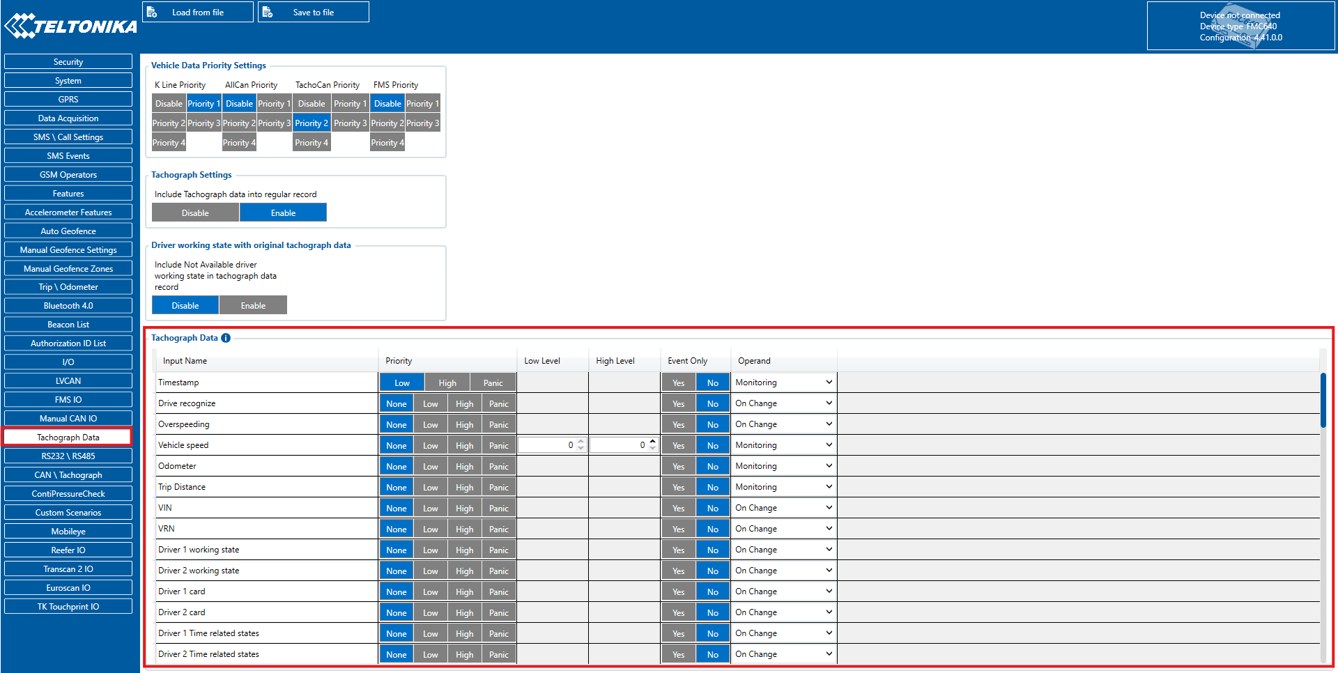

I hope you are doing well. Tachograph Data parameters that can be fetched from the device are available on the Configurator.
However, if you have clarifications regarding the other parameters that you want to fetch from the device. Suggesting you to coordinate with your Sales Manager so we can further assist you.
