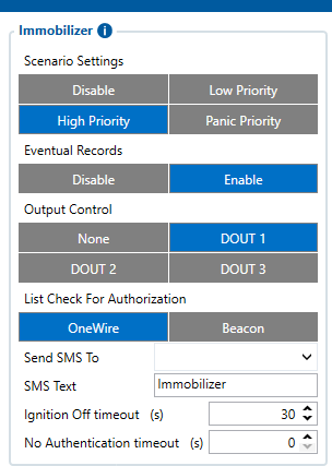

Have you reviewed the immobilizer feature?
In this functionality, when the ignition is turned ON, Dout activates and goes high. If a buzzer is connected to Dout, it will continuous beep until an I-button key will tab to 1-wire reader.
Check the more details from the link FMC234 Features settings - Wiki Knowledge Base | Teltonika GPS
