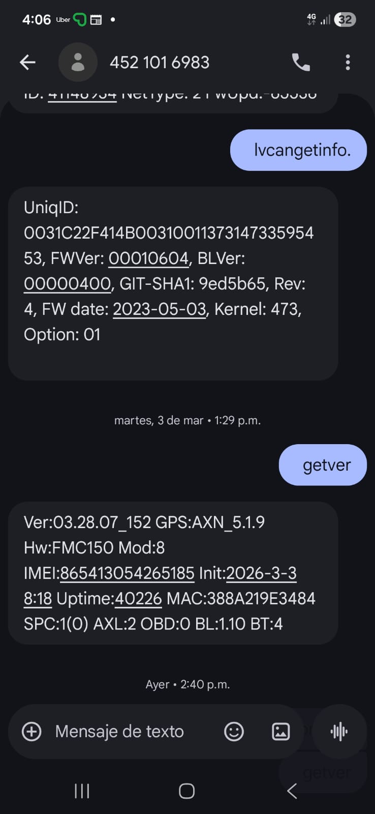

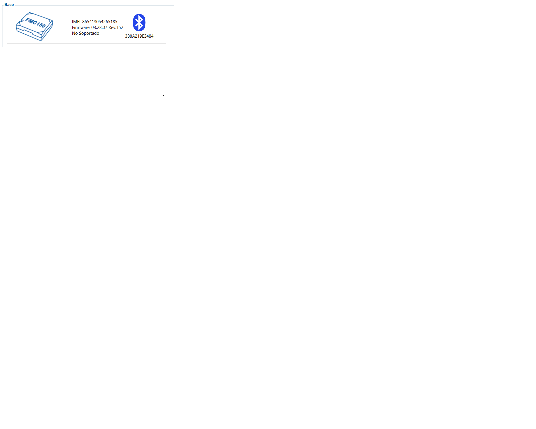

I need to update the firmware of my FMC150 because I can’t access my device from the Teltonika configurator; it displays a message that says “Not Supported.”
Current firmware: 03.07.28 Rev. 152
Required firmware: 04.01.00 Rev. 08
I don’t have access to FOTA web.
