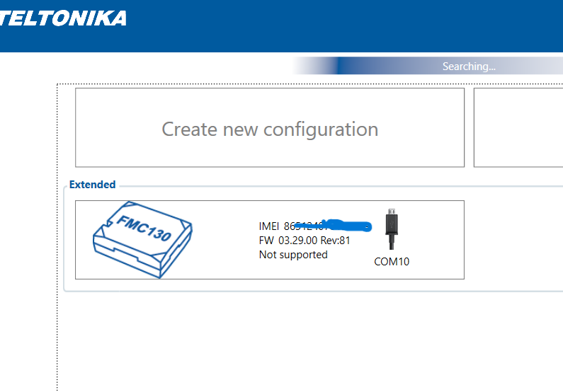

Hola, he intentado diferentes versiones del programa configurador y todos me dicen que el dispositivo no es soportado.
que puedo hacer???

You may need to use the recommended Configurator version for your device, as I believe this is not a general-release firmware. Therefore, I am unable to provide the exact required Configurator version.
What I can share is the Configurator download link. I suggest using the version compatible with firmware 03.29.00.rev.18 from the link below and checking whether the firmware is supported there.
Additionally, I recommend opening a support ticket for further assistance. If you do not have Helpdesk access, please contact your seller or your Teltonika Sales Manager, who can help raise the request on your behalf. This will allow us to investigate the issue and provide more accurate support.
