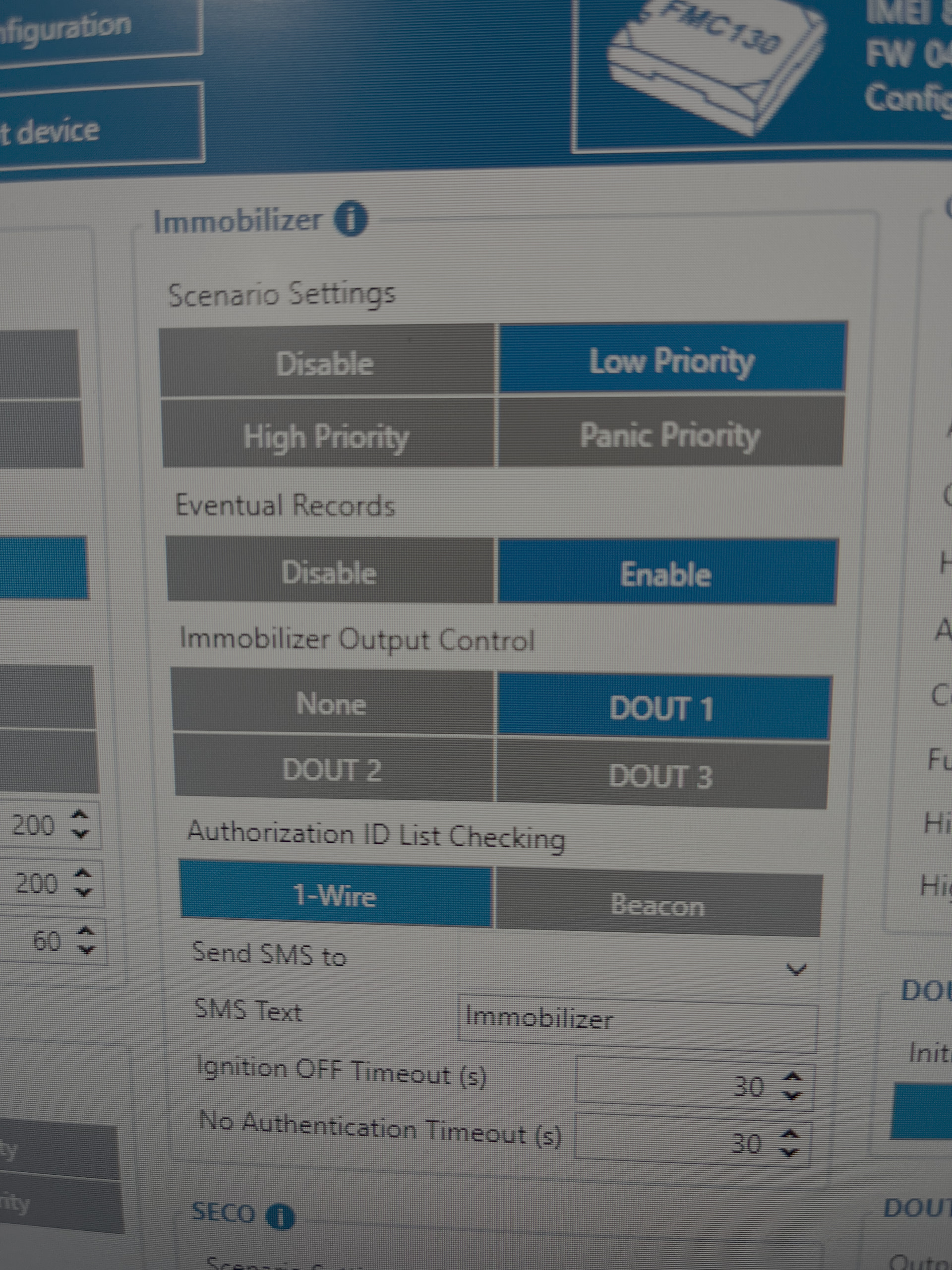

I have enabled the immobilizer with an authorized badge. When I start the vehicle and badge, it does not deactivate the immobilizer and the car refuses to start. Is there a specific setting related to time or another configuration for this to work?

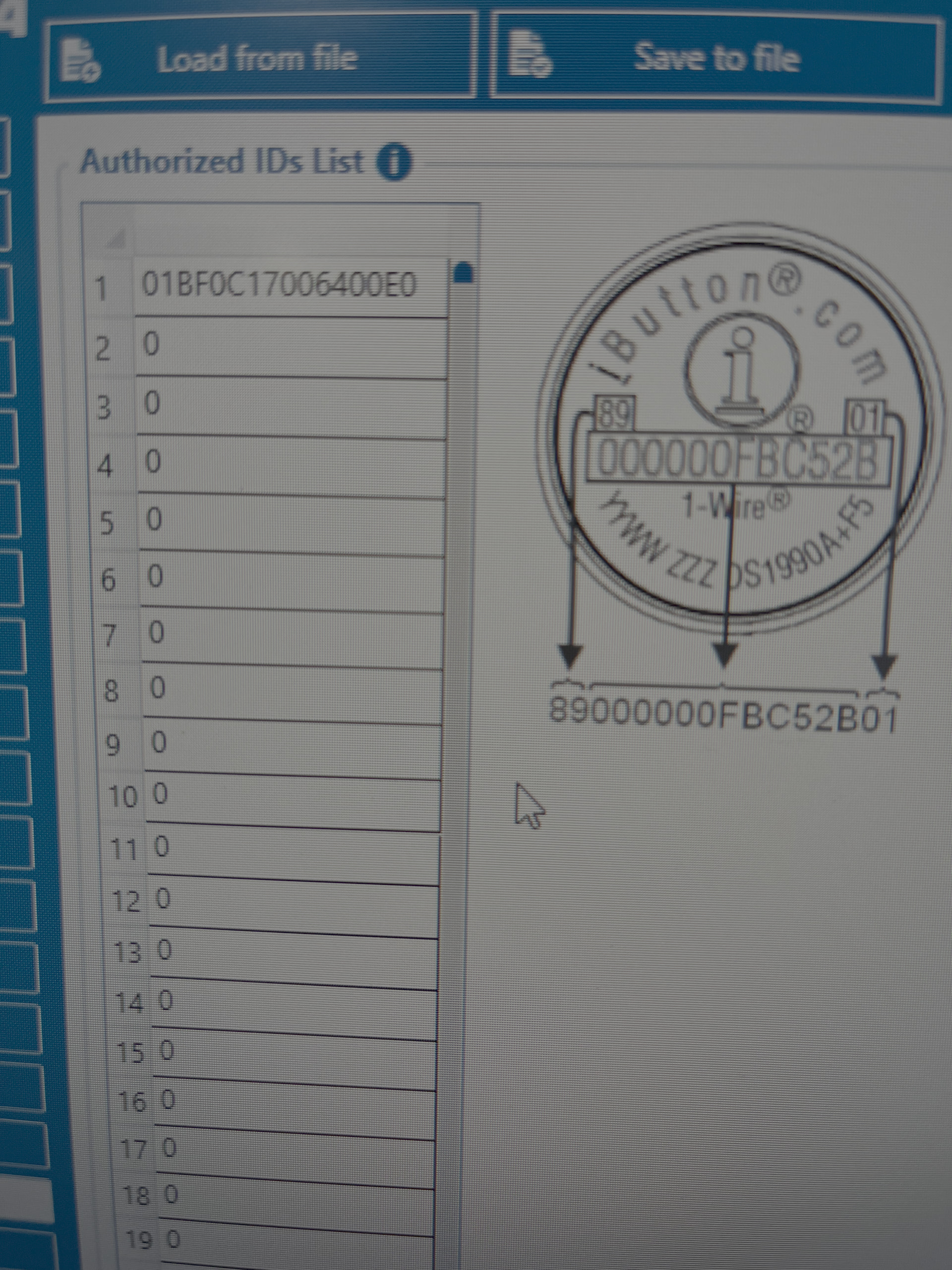

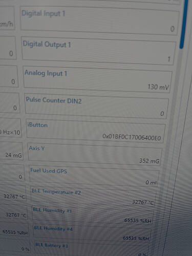

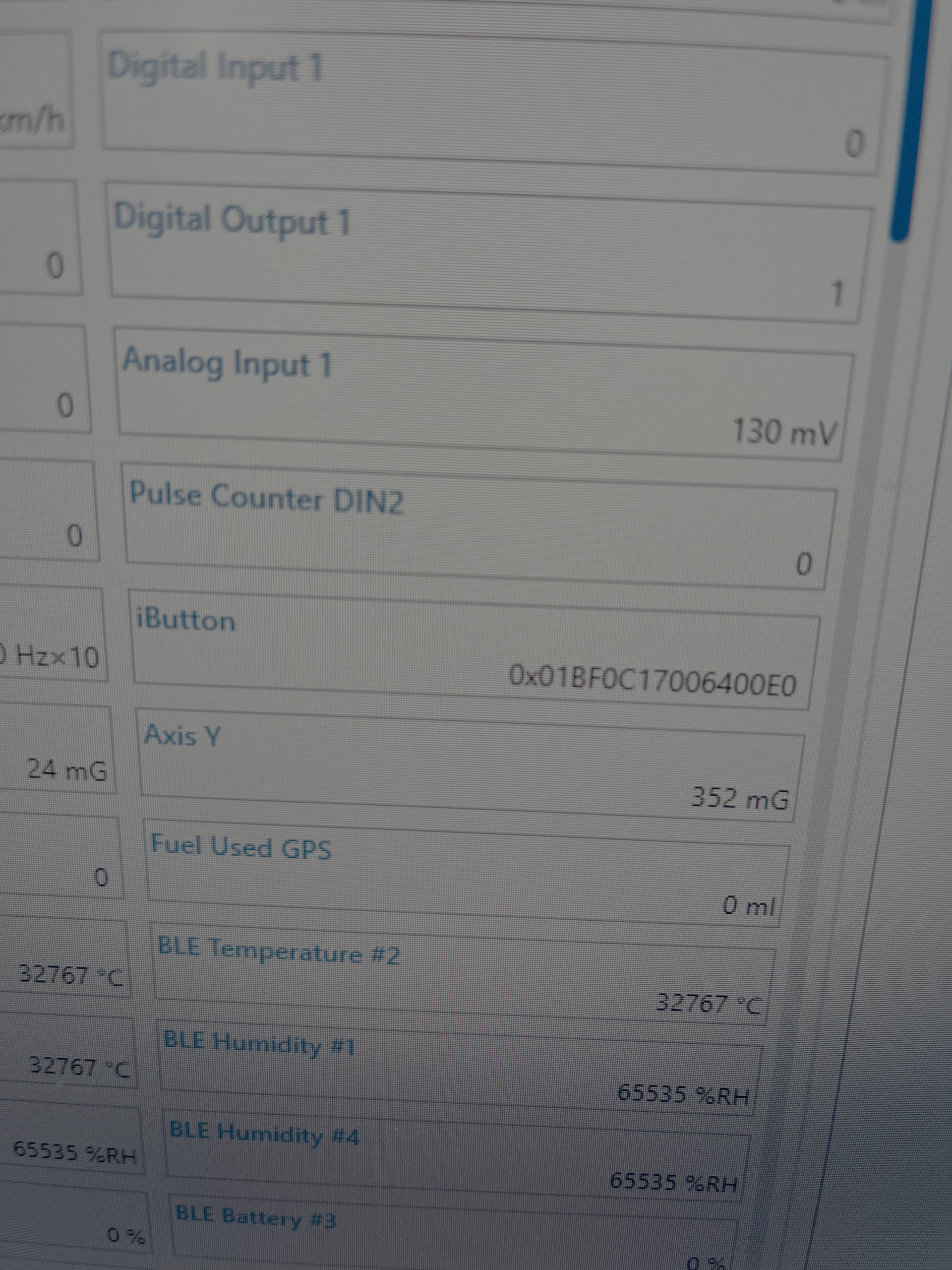

I have also attached screenshots showing the badge being read by the device, its addition to the authorized list, and the current immobilizer configuration.

Good Day,
Kindly configure the iButton ID in reverse order. In your case, enter the following ID in the Authorization list:
E0006400170CBF01
After making this change, save the configuration to the device and test again.
