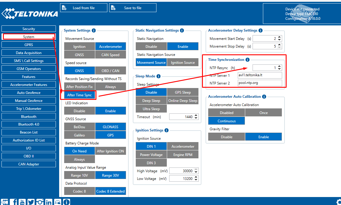

Good day,
Please kindly follow the troubleshooting steps below:
  • From the System select After Time Sync
  • Then from the Time Synchronization
  • NTP Resych (h) : 1
  • NTP server must be whitelisted to your SIM card to synchronize the time.
These settings will allow your device to synch first its time before saving/sending packets to your server.
You can also try to update the firmware of your device to the latest version which is 03.27.13.rev.443
Please click this link: https://wiki.teltonika-gps.com/view/Special:Redirect/file/FMB.03.27.13.Rev.443_and_configurator.zip
Visit our wiki page for the latest firmware and configurator: Firmware versions - Wiki Knowledge Base | Teltonika GPS (teltonika-gps.com)
