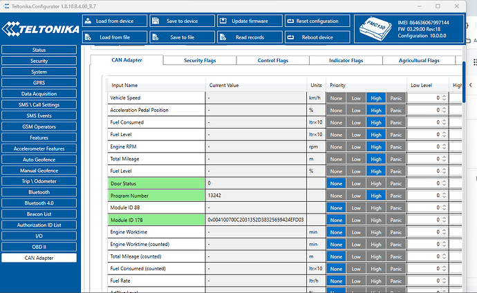

We are testing FMC130 with LV-CAN 200 adapter to ECAN. This is on mercedes benz C204 and we saved the program number as per attached screen shot, however we are noticing that the fuel paramaters cannot be read. What could we be missing in this case?
Hello @alexmadalo,
Good day! I recommend you to create a Helpdesk Ticket or coordinate with your Sales Manager so we can provide you the suitable Connection Scheme and Program number for your vehicle.

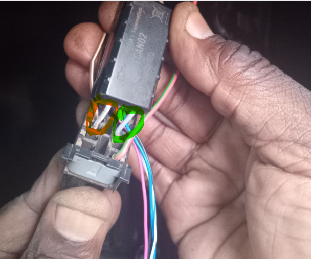

Hi, it looks like you haven’t connected it properly by first look. Can you tell me the wire colors you used for CAN1 and CAN2? Pictures would be great!
We have connected the CAN high on OBD pin 6 (highlighted in red in the attachment) and CAN low on OBD pin 14 (highlighted in green). Refer to the attached picture.
Got it, in the Mercedes-Benz C-Class W204, you have to connect CAN1 to brown/red (high) and brown (low) wires. They are internal CAN wires, so should look for them after removing trim near the OBD port and around
Thanks for this, i will try that and revert.
