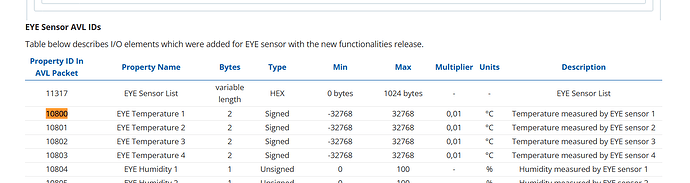

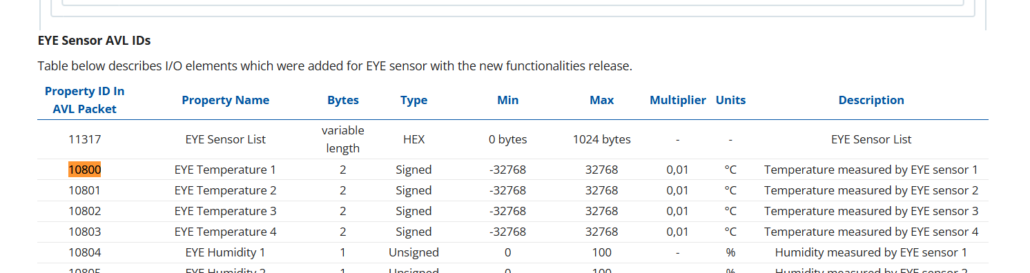

Good day, it seems there is an error in parsing from your server, the value should be in signed 2 bytes
Reference: EYE SENSOR / BTSMP1 - Teltonika Telematics Wiki
Best Regards
Maynard C
thanks for the answer, I checked what you mentioned and indeed it was a problem on the platform side, it was necessary to update the code to solve it.
