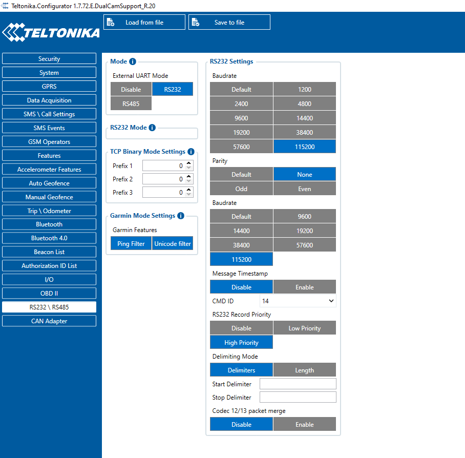

when i use this configurator and open my configuration file. Here i am not able to get DUALCAM section here.
