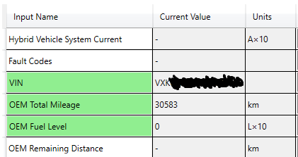

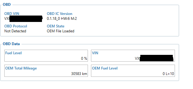

Hello Craig,
I hope you are doing well. Could you help to check on the Configurator if the OBD Parameters turns to green or is there any data that were read from the device under Status Tab>OBD Info?

There appears to be some data but not a lot from the OBD ?
As Have some information is there anything I can do ? or should I be raising a Helpdesk ticket ?
Can you provide the VIN (you can omit the last 6 characters for privacy)?
Thank you. Please execute an OEM reset (either via configurator button or SMS/GPRS command oemreset) and check the parameters again
It appears to be working thank you :grin:
