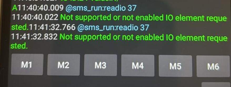

@sms_run readio 37 ( for vehicle speed )
When I sent this command
The response is as shown in the upload ( not supported or not enabled io element requested )

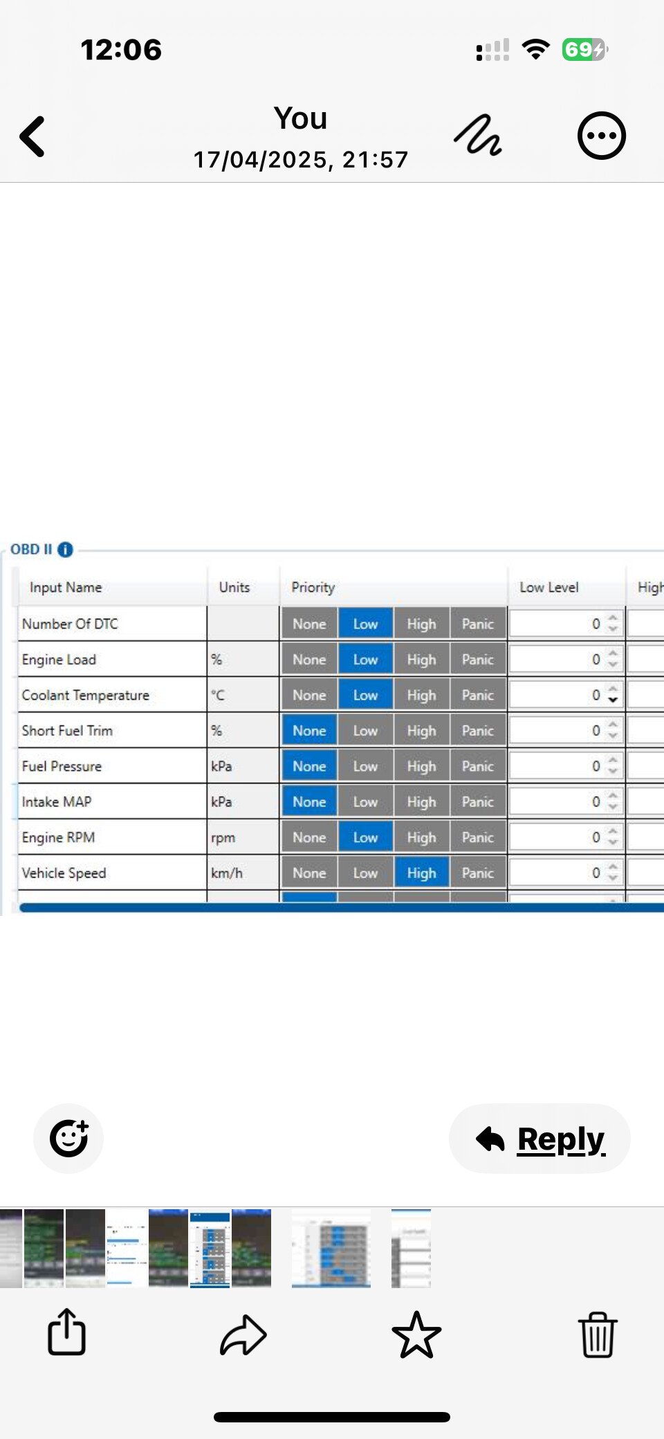

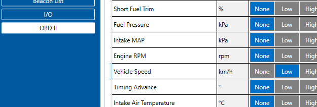

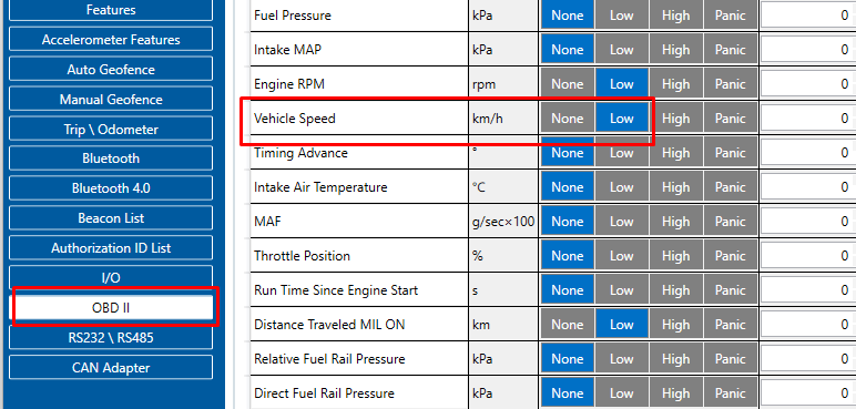

Hi Please make sure that the Vehicle speed from the OBD tab is enabled

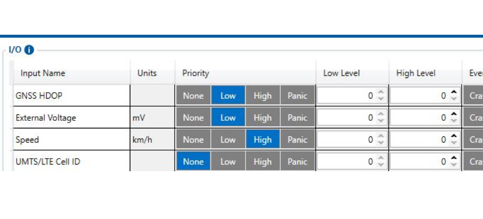

These are the screen shore for the config tool and also the command I send to the tracker and its response
Please advise if the command syntax is correct and the IO is also correct for OBD vehicle speed as clearly the tracking suggests in its reply it does it recognise the command

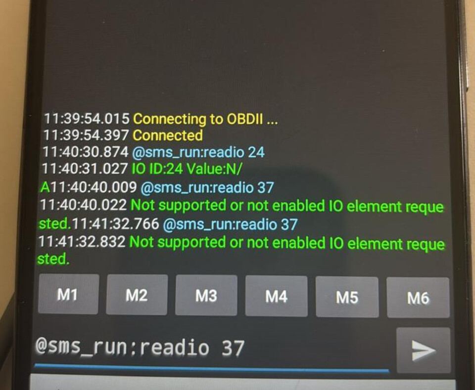

No I am testing with obd2 powered to 22 volt but not attached to vehicle
This however does not matter from my experience as when I send comment getvin it returns an NA value as the obd2 is not connected to the car which makes sense.
So if proves to me vehicle speed should return similar na value not an error message advising as shown in screen shots in this post
Can I please have someone confirm that command I am sending to request for vehicle speed from obd2 is in the correct format and correct is value

i am able to test the command @sum_run:readio24 *this being the GPS speed not the OBD@ speed) whilst the fmc003 is not connected to the car yet powered by 12v and it returns a 0 value which makes sense as the obd2 is stationary. Given this logic would not sending the 37 command to the obd2 return a similar 0 value rather than the error message. "NOT SUPPORTED OR NOT ENABLED
Vehicle speed should be available for the OBD parameters
To get OBD parameters please make sure it is connected to the OBD port of the vehicle
