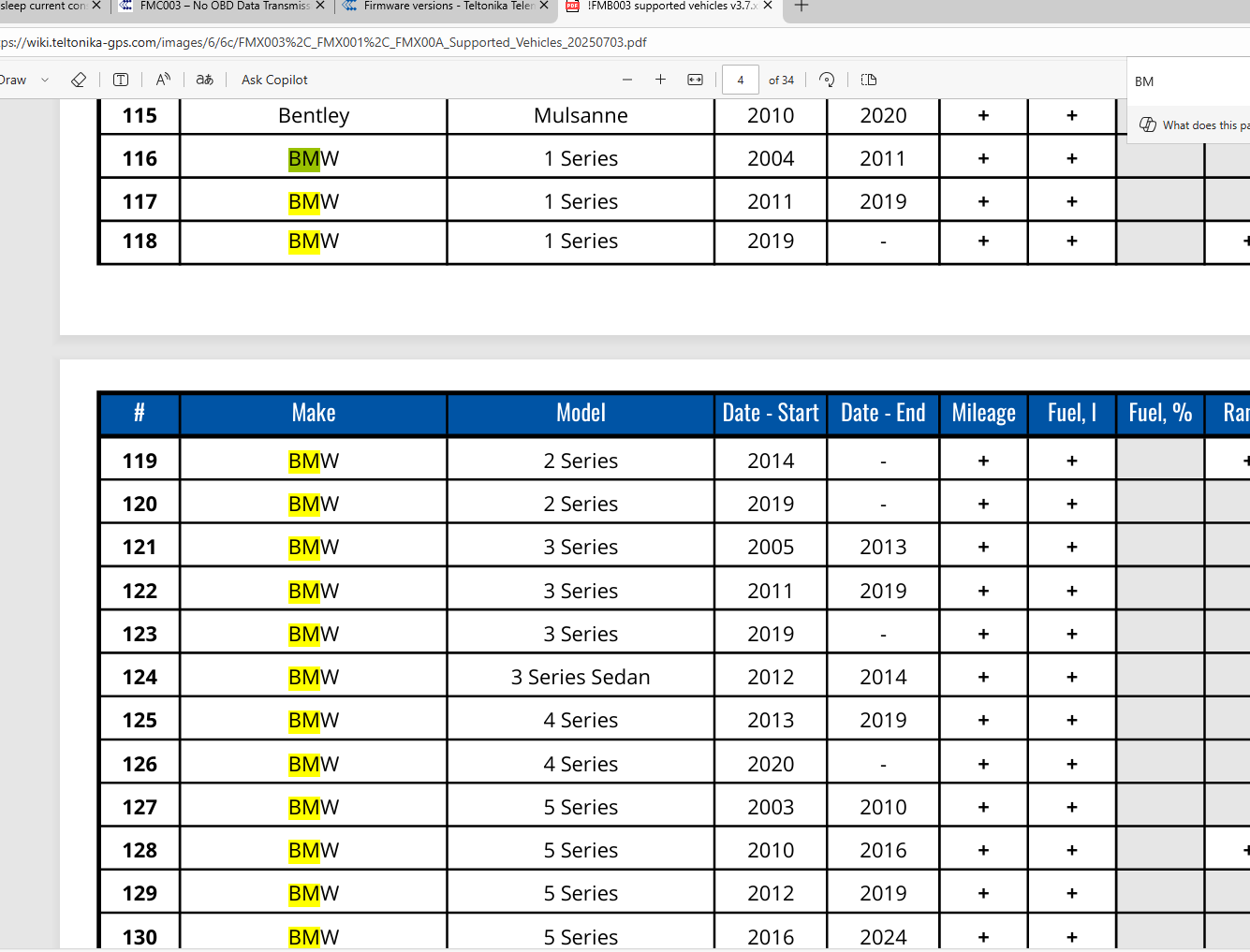

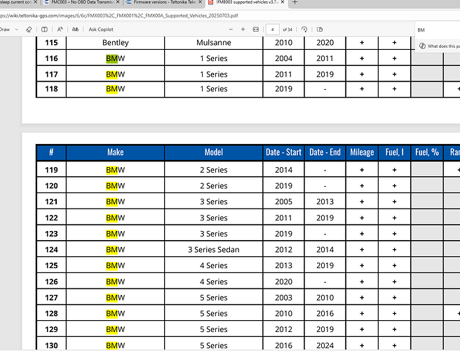

My vehicle is a BMW E92 335i (2007). Although this model wasn’t listed as supported in 2024, it now appears in the latest supported vehicle list.
Line 121

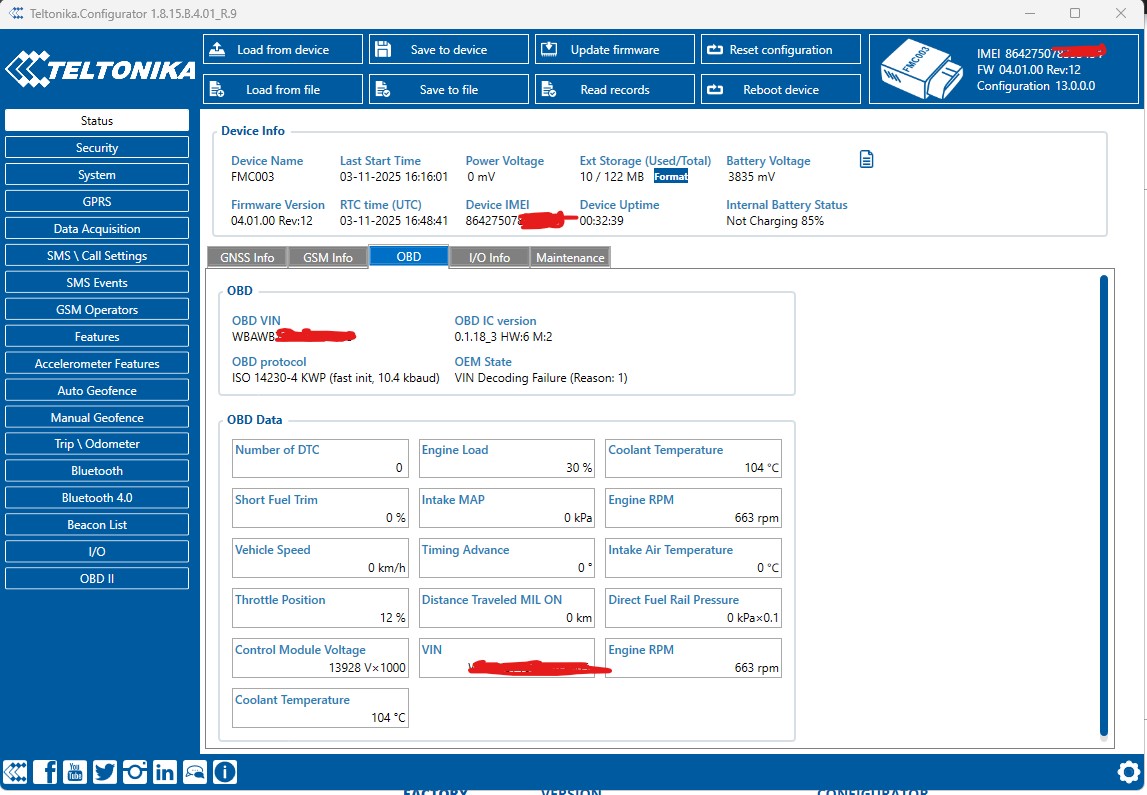

Currently, I only receive basic data such as ACC status and speed, but no detailed OBD information. When I connect to the FMC003 via Bluetooth, I can confirm that OBD data is being read correctly — however, it isn’t being transmitted to Traccar.
Troubleshooting Performed
  • Checked transmitted data logs — no OBD data appears to be sent.
  • Verified OBD data availability via Bluetooth — data visible (see attached screenshots).

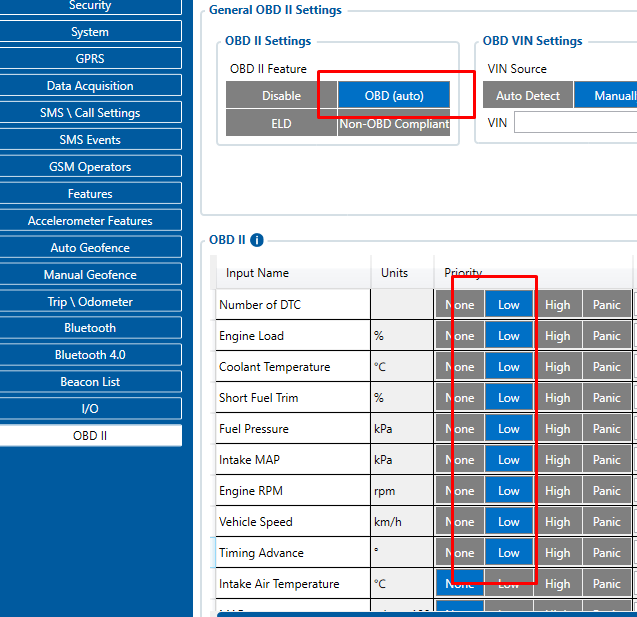

  • Confirmed that OBD data transmission is enabled (“Low” setting in configuration).
  • Updated the FMC003 to the latest firmware, but the issue persists.
  • Using Codec 8 Extended protocol (configuration screenshots and log file attached).

I believe I’ve identified the possible cause.
In the OBD status section, I’m getting a VIN decoding failure, and the log repeatedly shows the following error:
[2025.11.03 14:51:21]-[OBDII] WARNING @ 2824: ECM Header not found! Cnt:0
This vehicle should use the ISO 15765-4 (CAN bus) diagnostic protocol, but the FMC003 reports ISO 14230-4 (KWP) instead. This suggests that the supported vehicle list may be incorrect or incomplete for this model.

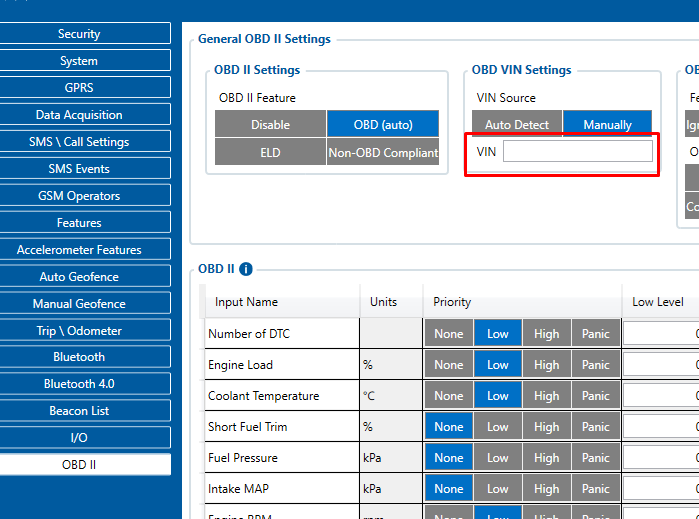

Hi, good day based on the screenshot that you have provided the VIN is not detected automatically so next step is to configure the VIN manually after that send oemreset , this is only applicable for supported vehicles.
But in your case.
BMW 3 series 2007 is not in our supported vehicle list. the steps provided above will also not help to get the oem data

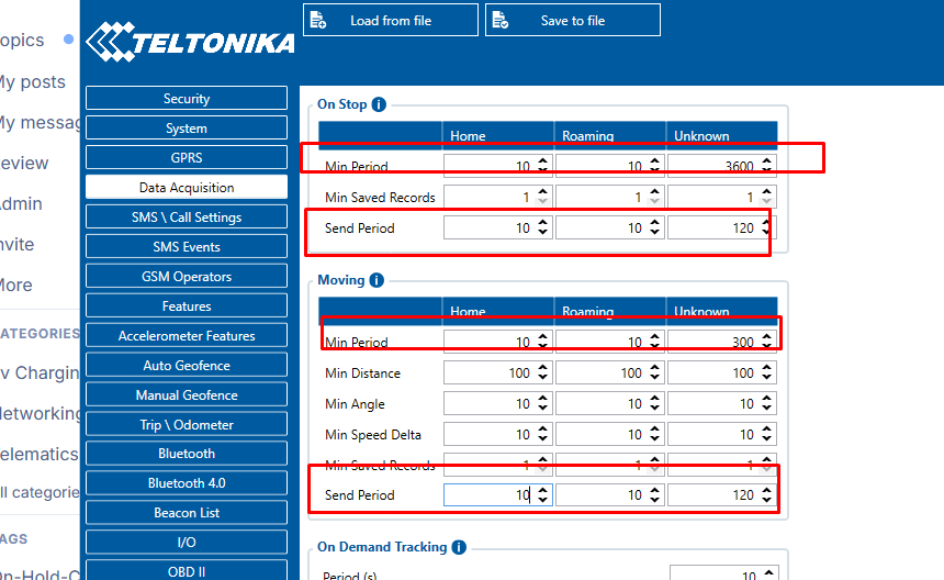

Regarding the data, make sure that parameters that you need are set to low priority
For testing purpose, make sure that the data sending interval is 10 secs
