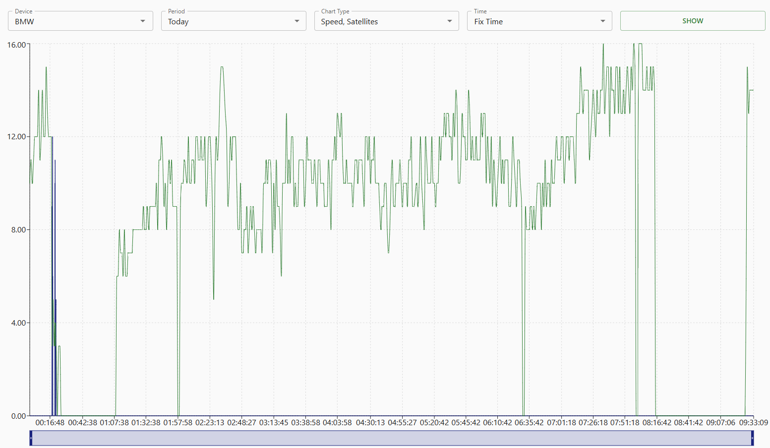

I’m attaching my traccar report with number of satellites.
I use FMC003 in BMW iX EV in OBD port. It fails to report data because apparently it looses the FIX as soon as I start the car. Everything seem to work of if I just disconnect it from OBD and lay on dashboard.

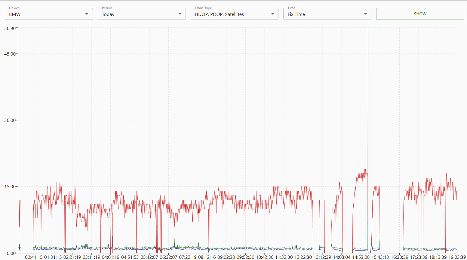

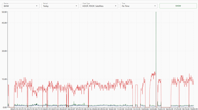

One more chart with number of satellites and HDOP , PDOP to show the qualoty of reception and gaps when I was actually driving

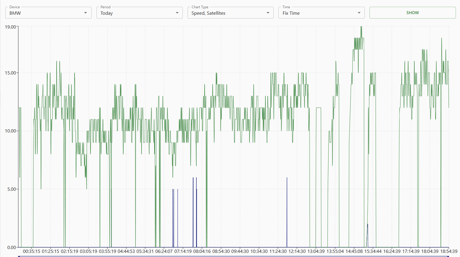

Continuing to investigate a problem. Looks like a wider problem to aquire a gps fix.
This morning I unplugged the FMC003 before starting the vehicle. All the satellites disappeared and nothing was reported for the whole drive.
