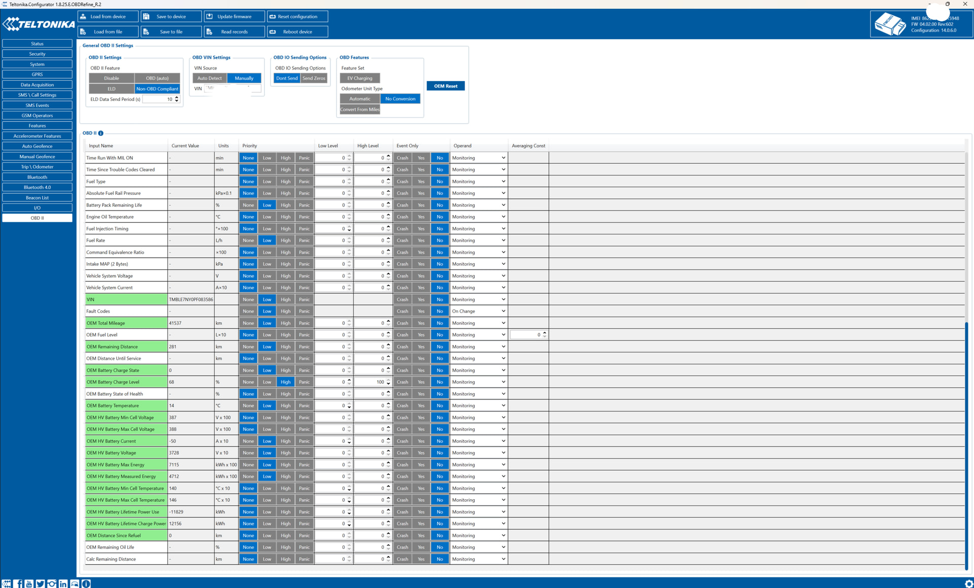

If I connect to the FMC003 with Teltonika Configurator while the vehicle is parked or charging, I can still see all EV values correctly in:
Status → OBD
For example, while the car is standing still and charging, the Configurator shows:
  • OEM Battery Charge Level
  • OEM Remaining Distance
  • OEM HV Battery Voltage
  • OEM HV Battery Current
  • Battery Temperature
The data is clearly being read successfully from the vehicle.
However, these values are not transmitted to Traccar while the vehicle is stationary.

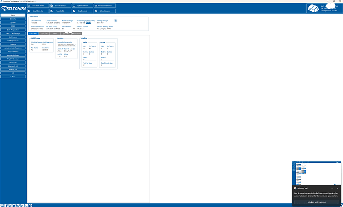

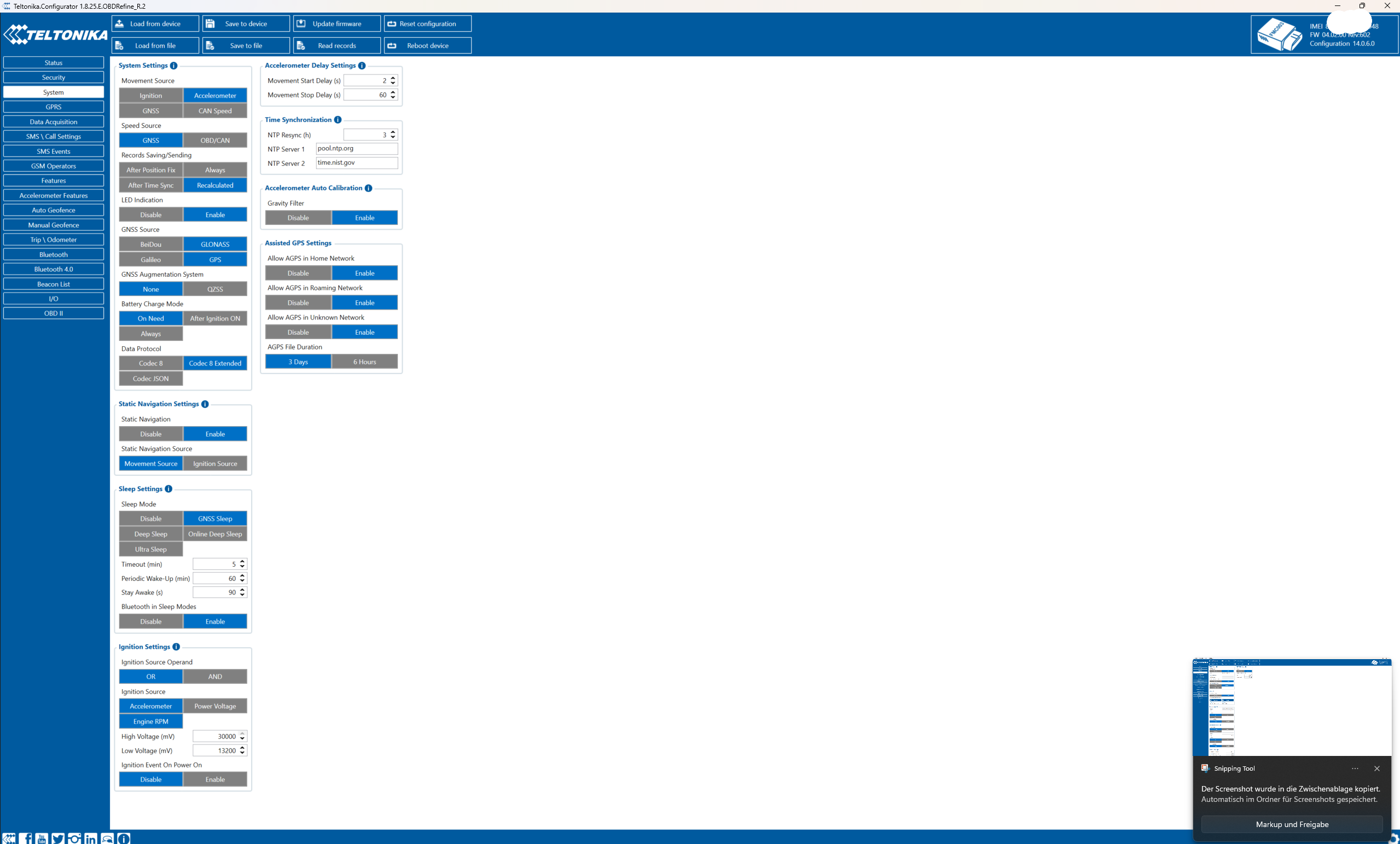

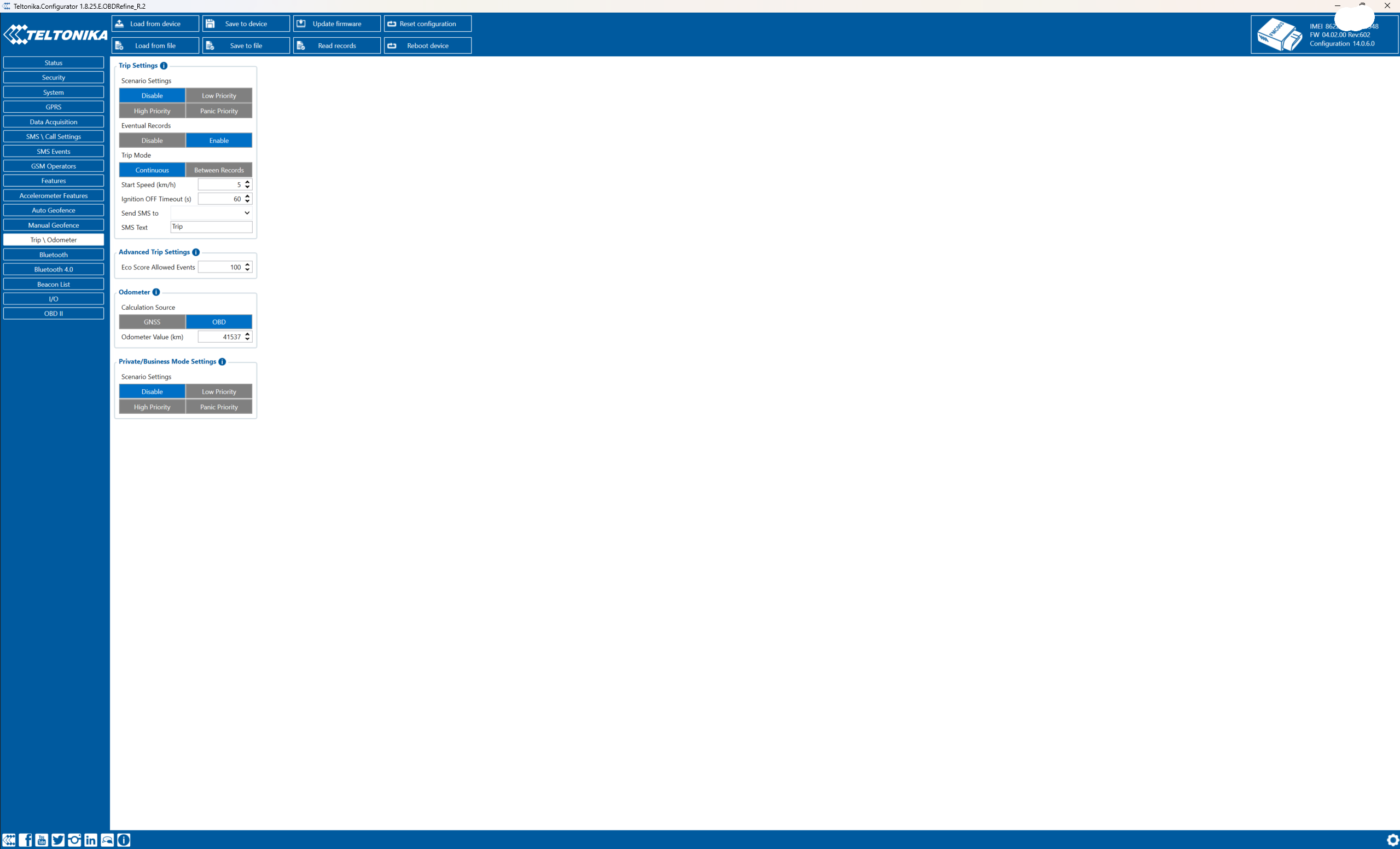

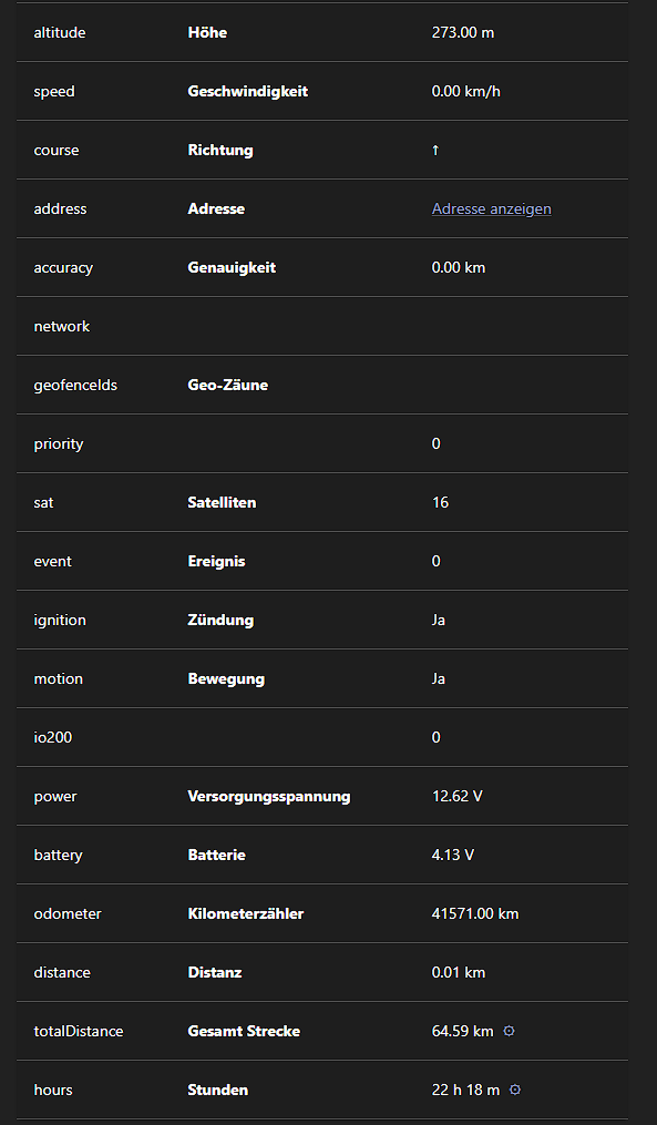

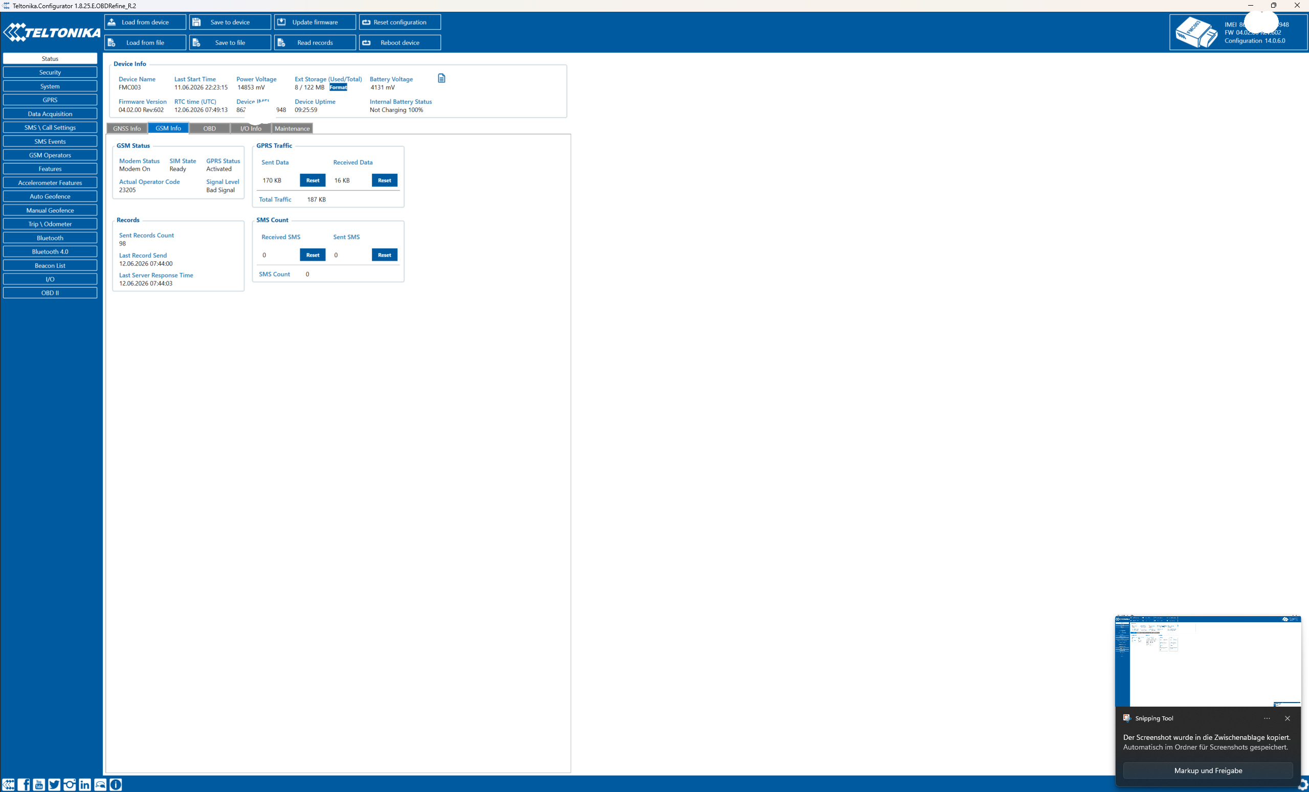

Additional information / Update
I have now changed all relevant settings to prevent the device from entering sleep mode and to keep both Ignition and Motion active at all times.
In Traccar, the device continuously reports:
  • Ignition = Yes
  • Motion = Yes
  • GPS fix available (16 satellites)
  • Regular AVL records are still being received
Screenshot attached for reference.

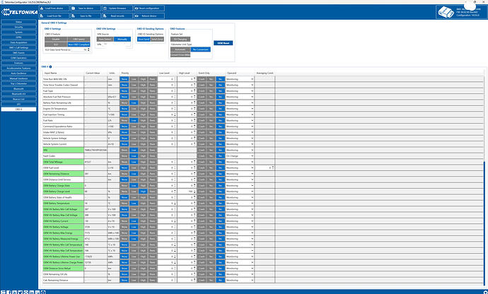

The State of Charge (SoC) and other OBD parameters are transmitted correctly while driving, but as soon as the vehicle stops and remains stationary (or while charging), the SoC value eventually disappears from the AVL records and is no longer sent to Traccar.
What is confusing is that when I connect with Teltonika Configurator, I can still see all OBD values live, including SoC, even while the vehicle is parked or charging. This suggests that the FMC003 is still able to read the OBD data successfully.
The issue seems to be that the OBD values are no longer included in the AVL records once the vehicle is stationary, despite:
  • Ignition = ON
  • Motion = ON
  • No sleep mode intended
  • OBD values visible in Configurator
  • Vehicle connected to a charger
