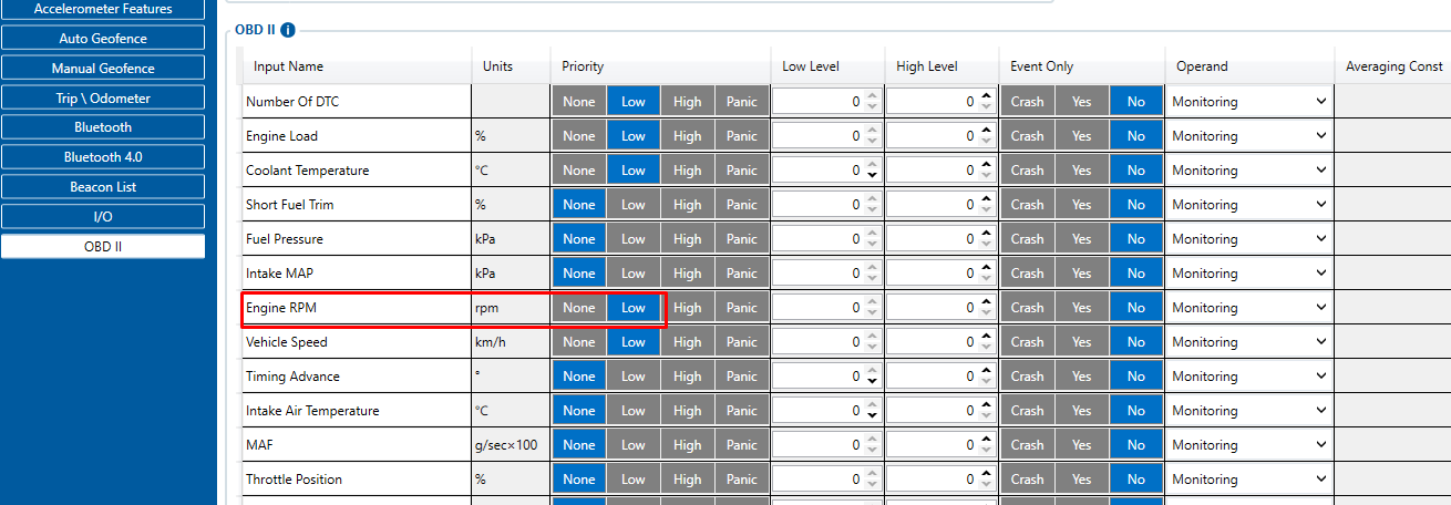

I am experiencing an issue with the FMC003 tracker: it does not recognize the engine RPM as an ignition source, even though it is displayed in the OBD data under can.engine.rpm . The latest firmware is already installed on the tracker. Is this a known issue? For ignition detection, only voltage and movement work for me.
How did you configure the device? please check if your configuration is the same.

It is the same!
Ok, please check the AVL ID 36 for engine RPM, value is avialable for this AVL ID then ignition should be ON for you should received AVL ID 239 :1
