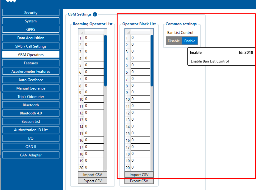

You can add a ban list from your device so that it will not connect to any network that you do not permit.

So I need to search the MCC/MNC for maritime providers as well as Russian providers. I’ll add them to the black list and the ferry/driving near the Russian border should be no problem. The device will not connect to any of the networks on the black list. Thank you!
