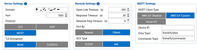

However, when configuring MQTT, we noticed that only AWS and Azure seem to be available as client types. For our use case, we require integration with a custom MQTT broker (Mosquitto), including support for authentication via username, password, and/or certificates.

Thanks a lot for the feedback @Patrick_Sangalang, I’ll be reaching out to support anyway because of our project BUT:
I got it working:
  • Set up a VPS with Eclipse Mosquitto as the MQTT broker
  • Configured the broker with TLS using our own CA certificate
  • Created client certificates and signed them with the CA
  • Uploaded the CA, client certificate, and key to the tracker
So basically exactly the same setup we need for AWS Custom according to your instructions.
I’ve been testing it for 24 hours now and everything is working fine so far!
Is there anything on your side that would speak against proceeding this way?
Hi Thomas,
may I ask how you got working this.

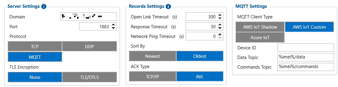

I try to get the MQTT aata from a FMM003 device but no packages where send to my server. If I change the settings back to TCP packages are comming in.
So how did you manage to get the MQTT data to your server?
Best regards
Thomas
