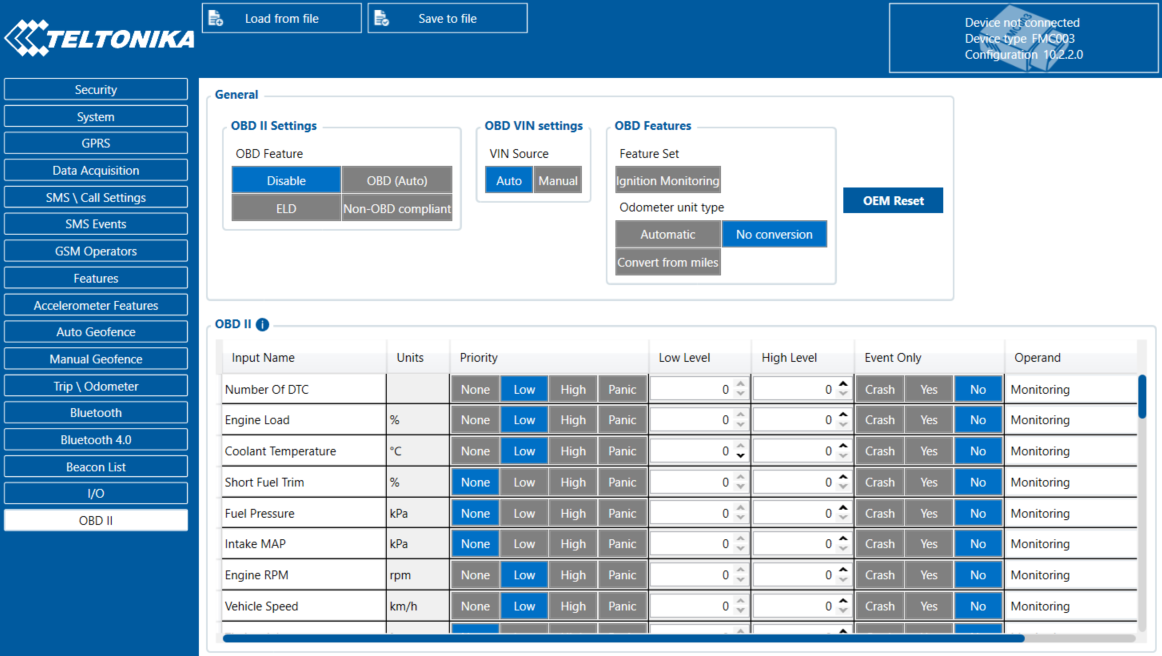

There is 1 unit which causing alert in dashboard of MB truck. Something like: There is connection in OBD interface, please remove. Any idea why such info is detected? So far we are needed only power and ground…
Hello @VesiRoosi21,
I hope you are doing well. I suspect that the vehicle might not support the current OBD settings from the device, Could you help to disable the FMC003 OBD functionality as provided below?
Hope this helps.
