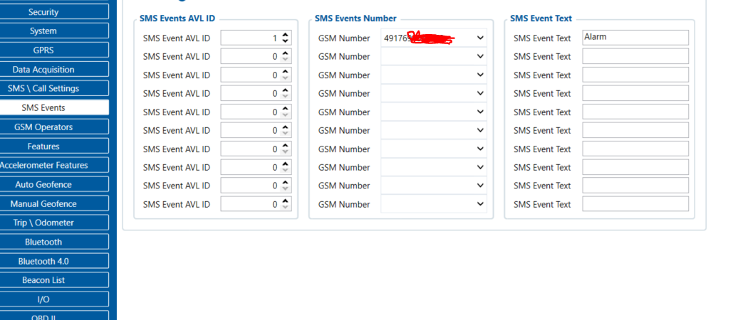

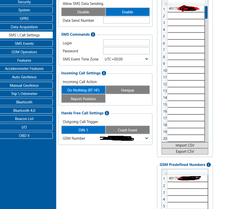

I do not receive an SMS. I want an SMS when the Digital Input 1 gets a 1 at the input. I am not sure if I have entered the correct SMS event. AVL ID entered.
In the “wiki page under ”Teltonika Data Sending Parameters ID“” the fmc920 is not listed.
Have I made a mistake at some point?
Firmware 03.29.00 Rev:21

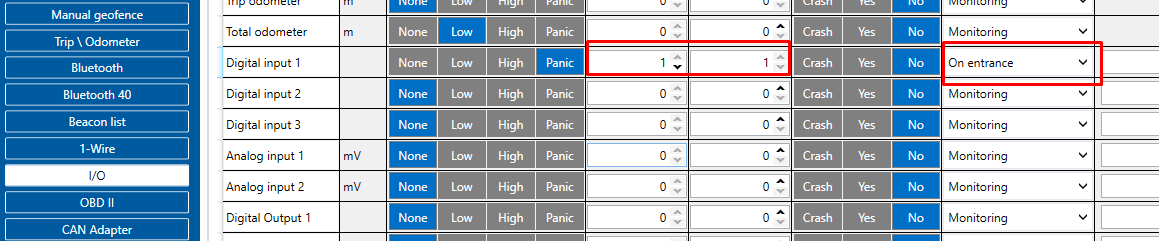

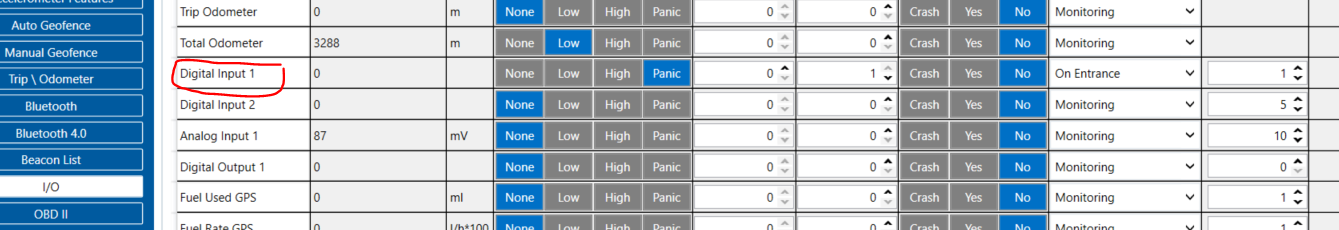

The High and Low value should be 1 if you want to monitor DIN 1 when the value is 1 and the operand is correct it should be On Entrance.
Best Regards
Maynard C
Thank you @Maynard, it works perfectly.
