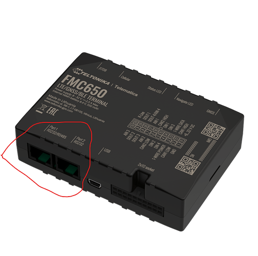

I have an FMC 650 and a Dual Dashcam. I want to connect DUAL CAM with FMC 650, physically I don’t have wires for RS232 but a port like an ethernet port.
From the camera, I only have wires to connect ( no ethernet interface).
Help me to figure out for physical connection.

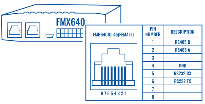

Hello @mgr,
I hope you are doing well. You may follow the RJ45 pinouts of the FMX6X0 series for connecting the RS232 wires from the camera using the screenshot mentioned below.
Additionally, Dualcam instruction and firmware versions can be found on this link: Teltonika DualCam - Teltonika Telematics Wiki
I hope this helps.
