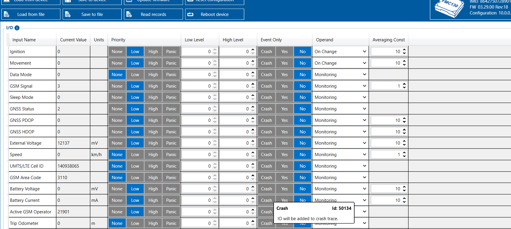

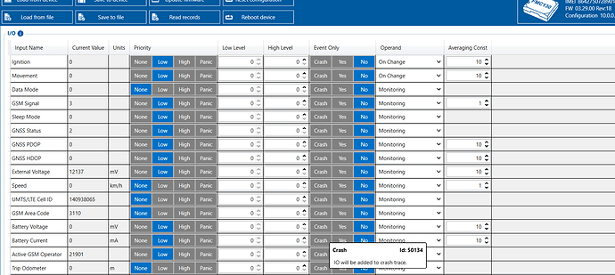

I am trying to configure my FMC130 and what i am trying to do is when an Digital Input goes from 0 to 1 i am trying to trigger an event that either sends an SMS or if possible HTTPS request… I’ve found on the tutorials there should be a screen where i can select the send to number and text on the I/O tab… but i dont have that on my configurator

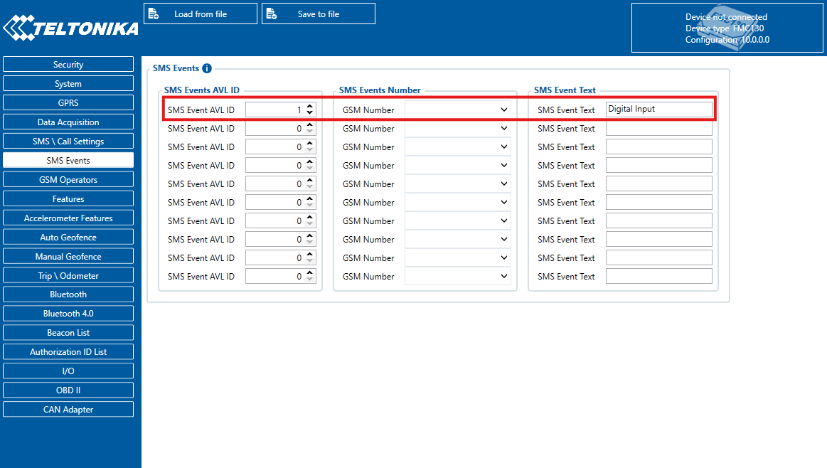

I hope you are doing well. SMS messages on the latest configuration would be available through SMS events. Here, you need to specify the AVL ID of the specific parameter you need to receive, for Digital Input 1, its AVL ID is 1.
The complete list can be found on this link: FMC130 Teltonika Data Sending Parameters ID - Teltonika Telematics Wiki
