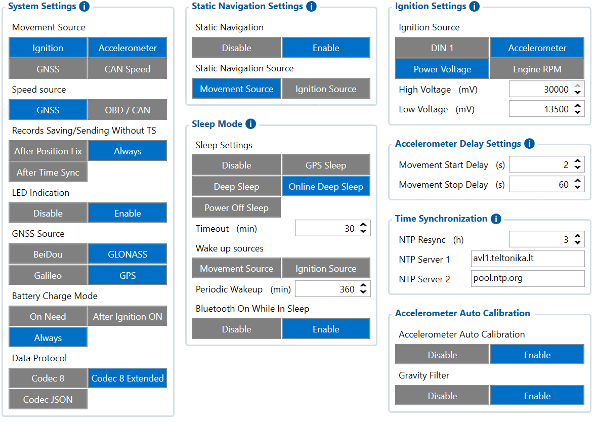

I can’t set the wake up sources in configuration.

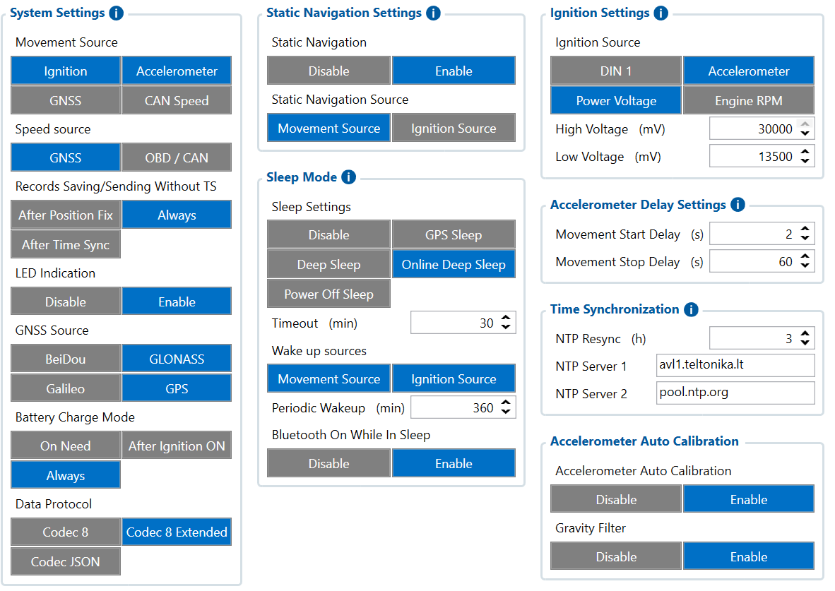

They will be always cleared if I read configuration back from device.
Set up and saved to FMB965:
Terminated Configurator and started again, read parameters:
Firmware FMB965: FW 03.29.00 Rev:932
Configurator: 1.7.72.E.FMB9YX_R.24
Regards
Carsten

Hello Patrick,
I can only click “Save to Device” if I change another topic.
The wake up source is also cleared when I load settings from file.
Regards
Carsten

Hello Patrick,
when I change some topics including wake up source and save to device it seems to work.
So it’s just the configuration software that does not show the correct values.
Thanks for your help.
