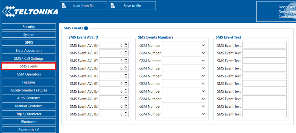

Hi I have a series of FMB965s for our vehicles including motor bikes. It states on the user guide that the device can send multiple sms messages to recipients in the event of a crash or tilt alarm. When selecting the sms number using the configurator drop down for each event it will only let you choose one number that’s listed in the sms events list which works fine. How do I get the device to send the sms alert to several or multiple numbers so that other people can be informed. Thanks K
Hello @Karlos1,
Good day! You may send SMS alerts on multiple numbers through Configuring the same Parameter ID/ AVL ID on the SMS Events for multiple numbers.
For more information you may refer to this link: FMB965 SMS events - Teltonika Telematics Wiki
Patrick S.
Hi Patrick thanks for your prompt reply. I have looked at this on the 965 configurator when setting the device up but crash and tilt are not listed in the event AVL ID. Pretty much everything else is so I couldn’t get it to work. Is this something you could check just to see if I’m missing the trick somewhere or would Teltonika add these 2 on the next firmware update. K
