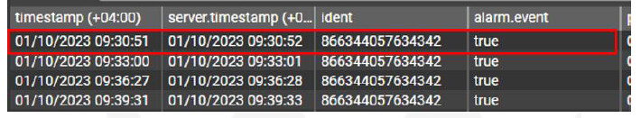

Please download the terminal here: Terminal program – Learn with Andøya Space Education
Please check for the alarm message from where the main tracker is disconnected, please also check your server and look for AVL ID 236.
Also please update the device firmware to the latest: TAT140 Stable firmware - Teltonika Telematics Wiki
