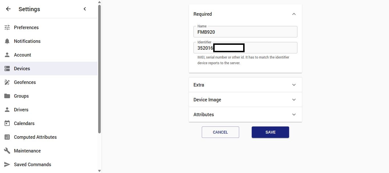

I installed my own Traccar server on a personal VDS server and configured the FMB920 to connect to my server.

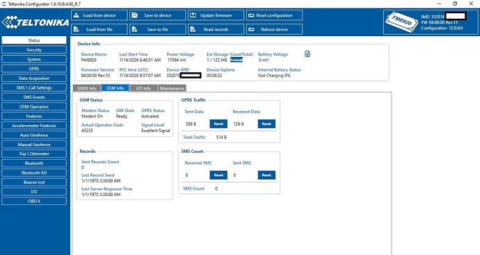

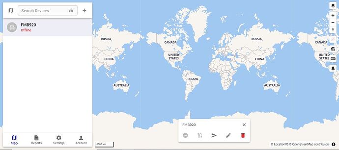

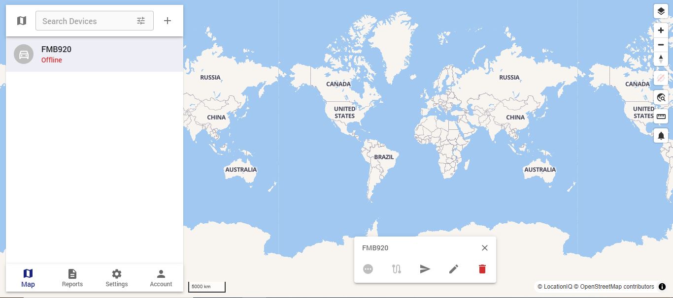

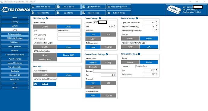

The APN settings, server address, and port configuration have been checked and appear to be correct. However, the device does not send any records to the server, and Traccar always shows the device as offline.

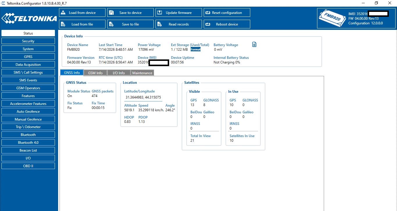

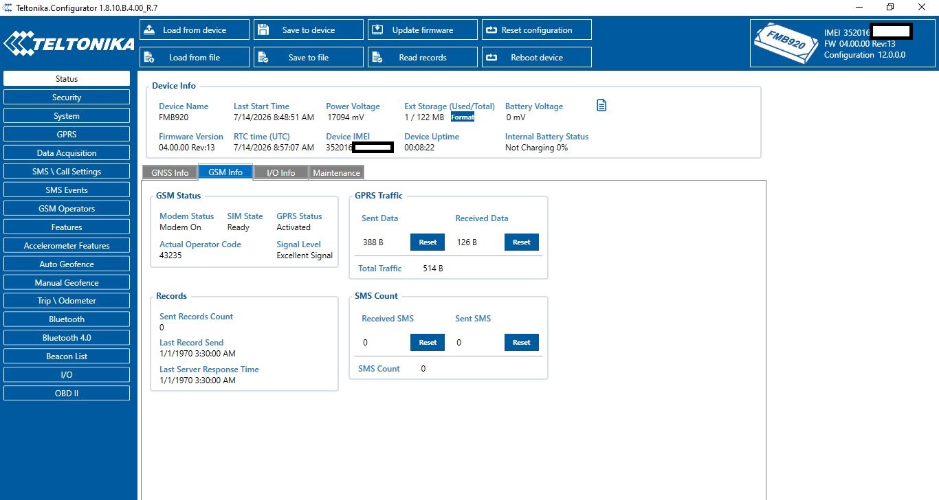

I have attached screenshots from Teltonika Configurator showing the device configuration and status information.

As per the screenshot shared, I can see that the device has a valid GPRS connection and has established a connection with the server. The Sent Bytes value also indicates that the device has transmitted a few data packets.
However, it appears that the server may not be accepting the incoming connection or sending an acknowledgement back to the device. In such a case, the device will stop sending further data packets until it receives a valid response from the server.

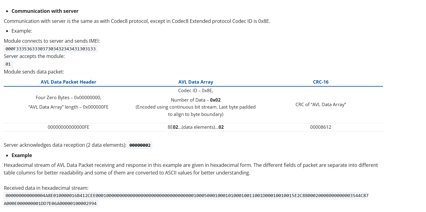

Please go to the GPRS tab and, under Record Settings , set the Record Type to TCP/IP . Also, ensure that your server is accepting the incoming connection and sending the required acknowledgement (ACK) back to the device, as described in the documentation provided in the link below.
