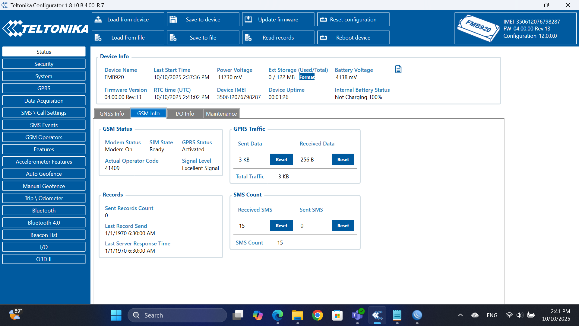

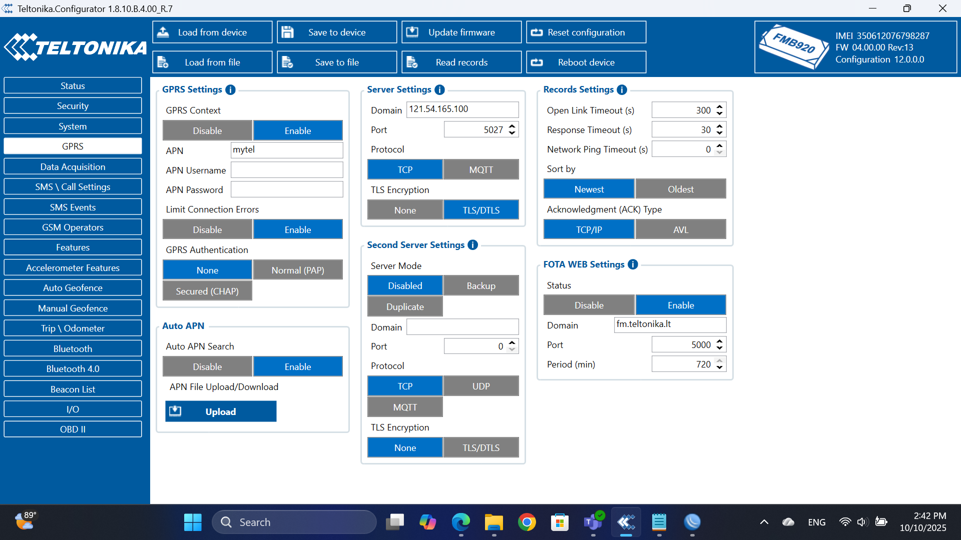

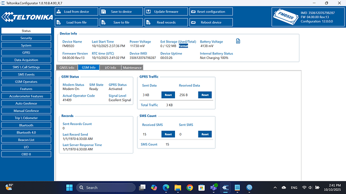

I’m facing an issue with my FMB920 device, which is currently not sending data to the platform. I have tested both TCP and UDP connections and also tried using Codec 8 and Codec 8 Extended, but the device still shows no response or data transmission to the server.
Could you please advise me on how to troubleshoot or fix this issue?

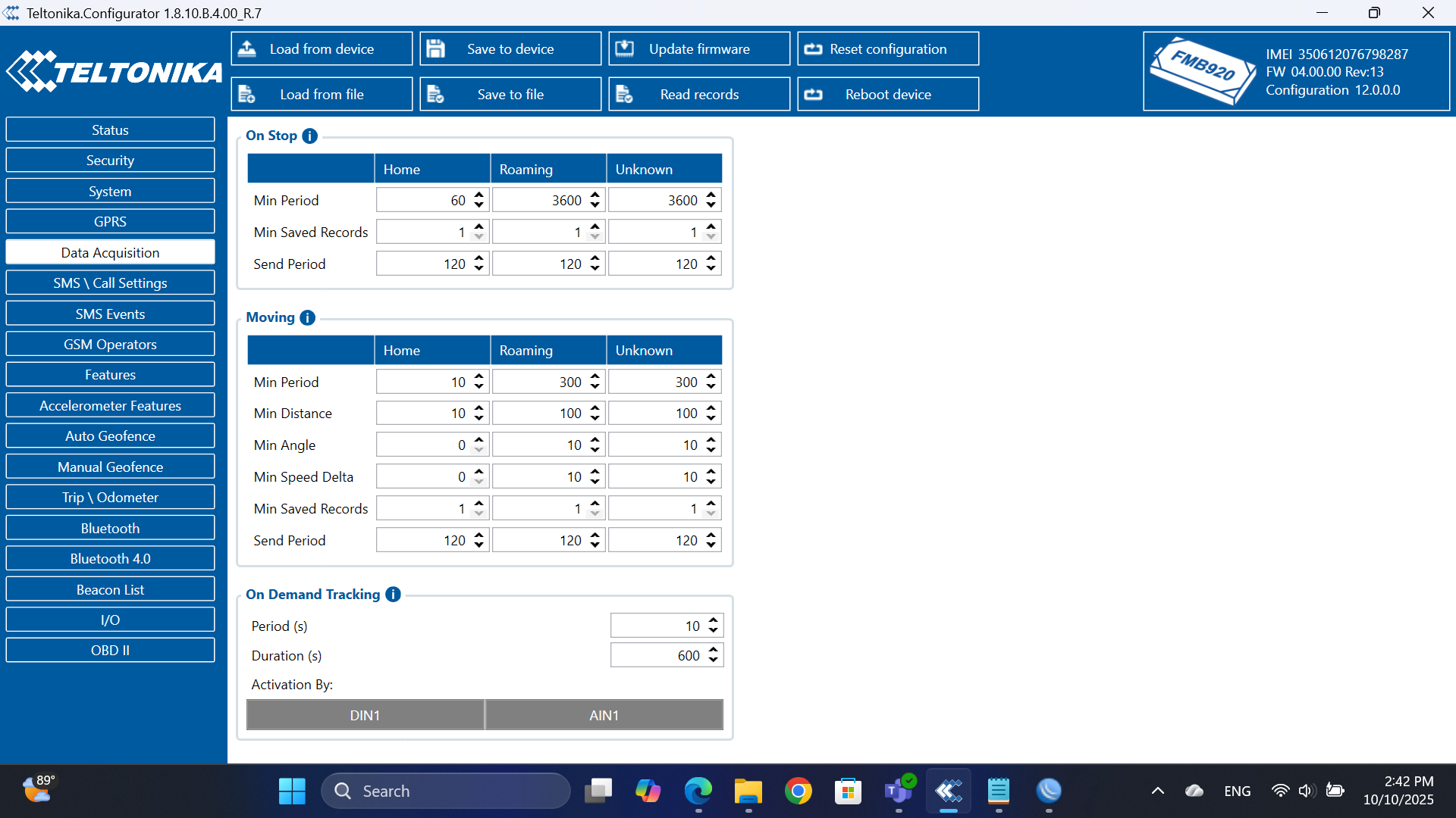

do you set some I/O to send events?
for example: Movement Prio > High, Operand > On Change
