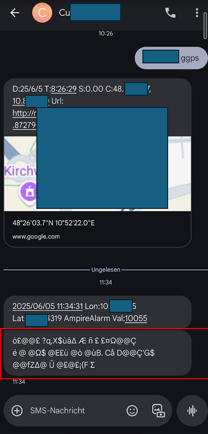

since some weeks I always receive 2 sms in alarm-case!?
Look in the Screenshot (box in red)
On other events ggps or getstatus, I only receive correct one readable sms.
Do you have any idea to solve the issue?

Hello @philipp,
I hope you are doing well. Can you help to share which parameters you have enabled to receive SMS from the device?
Suggesting you to update the device Firmware version to the latest one and see if it helps. Latest versions can be found on this link: Firmware versions - Teltonika Telematics Wiki
I hope this helps.
Patrick S.
Hi @Patrick_Sangalang,
thanks for help.
I did a firmware-update, no success.
But i found the parameter: I disabled sms data sending in the SMS-Settings.
