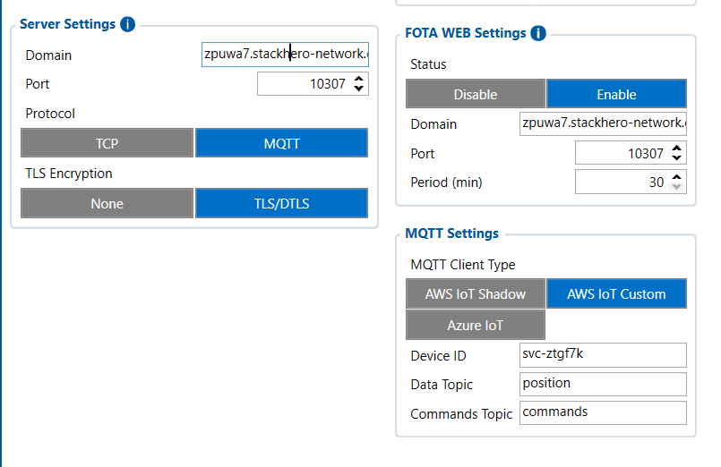

Hi everybody, I have a FMB900 tracker and I’m trying to send the gps position to a MQTT server.
What’s the problem? The MQTT server asks for user/pass. And in Teltonika Configurator, there’s no way to introduce user and password for MQTT server connection. (I can’t disable this option on the server and log-in without authentication)
Is there anyway that you know, how could i connect to the MQTT server?
Thanks in advance
Thank you for your message,
From the screenshot, it seems that the FMB900 is configured to send data to a custom MQTT broker (According to the Domain Name in the Server Settings), not AWS or Azure, right?
If that’s the case, please note that our devices support data sending over MQTT to Amazon Web Services (AWS) and Microsoft Azure only. Custom MQTT brokers are not supported.
