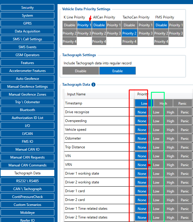

I read this document. My device send me that i am able to read LIVE tachograph data (K-LINE) but when i am checking it in my avl record i am not getting the live Tachograph data.
The available K-line parameters must be activated to be sent by the device to your server.
Details
https://wiki.teltonika-gps.com/view/FMB641_LVCAN_I/O,FMS_IO_and_Tachograph_data_elements
