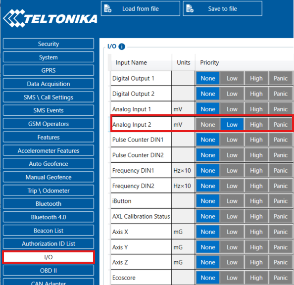

DI1:1 DI2:0 DI3:0 AIN1:131 AIN2:1935 DO1:0 DO2:0 showing value viam SMS but not sending the data to the server for AIN 2
Hello @CANON,
I hope you are doing well. You need to check the vehicle if the Fuel can provide an Analog Output so it can be received by the device.
On the other hand, you need enable the Analog Input parameter on I/O to Low Priority so you would receive the value on your server.
